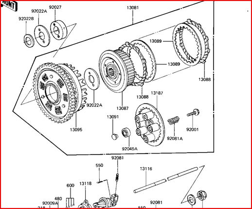

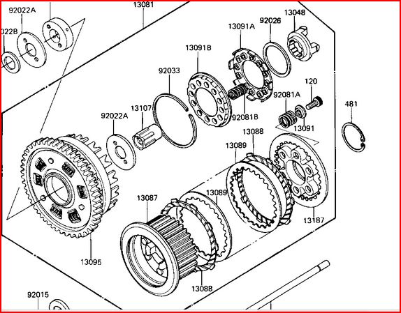

- Posts: 8405
Re: 83 KZ1100 Shaft Clutch slipping
13 Aug 2016 13:18 - 13 Aug 2016 13:21swest wrote: Mine aren't replaceable.
The shaft drive bikes have a different setup with more springs, 18 instead of 5 as I recall. Twelve of the 92081B and six of the 92018A.
Shaftie-
Chain drive-
Last edit: 13 Aug 2016 13:21 by TexasKZ.
The following user(s) said Thank You: jdvorchak
- Kray-Z
- I need more power Scotty....
- Posts: 583
- Thanks: 107
13 Aug 2016 14:18I think the shaft drive clutch has additional damping built in to lessen the shock loads on the transmission and driveshaft, something a chain does inherently...
Clutch basket damper springs are not replaceable by the home mechanic; the basket is held to the clutch primary driven gear with rivets....it takes special equipment to do that. Not that it has anything to do with clutch slippage problems, anyway. If those springs get weak, it causes noise and excessive backlash in the drive train, not clutch slippage.
