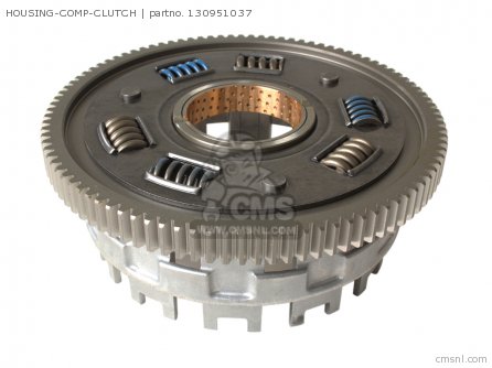

All I buy is gallon jugs so not a problem for me. One question about the clutch. I see on the parts fiche there are two different springs in the clutch assembly. One type uses 12 for something called dampener. The other is the normal 6 on the pressure plate. I was just going to change the ones on the pressure plate. Do the dampener springs usually wear out as well and should be replaced as a set?

Since all those springs are likely the same age, I'd be inclined to replace them all while it is apart.

TexasKZ wrote: Since all those springs are likely the same age, I'd be inclined to replace them all while it is apart.
I never have replaced any damper springs. Only pressure plate springs.

Mine aren't replaceable.

swest wrote: Mine aren't replaceable.
Most are not! It's a prebuilt unit, if we are talking about this:
