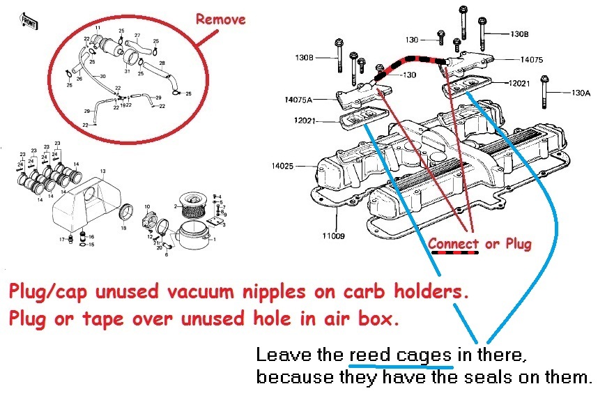

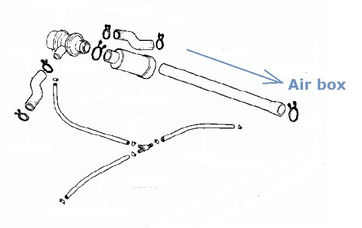

If the stock clean air paraphernalia is still fitted, all of it may be removed. And probably should be removed because it adds potential air leak sources and doesn't improve engine performance.

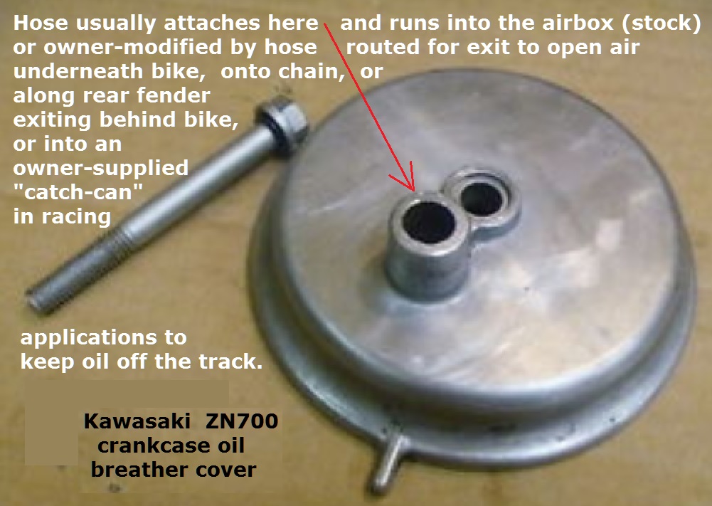

The crankcase oil breather (shown below) should exit through an attached hose either into the airbox or a catch-can or to open air.
The hose from the crankcase oil breather should imo NEVER have any sort of aftermarket mini-air-filter attached to the hose.
Such filter is imo absolutely useless, and causes trouble as it clogs with oil vapors and progressively obstructs free breathing from the crankcase.
Oh wait! The little mini-air-filter might help prevent dreaded oil-eating inter-galactic alien beings from invading the crankcase.
