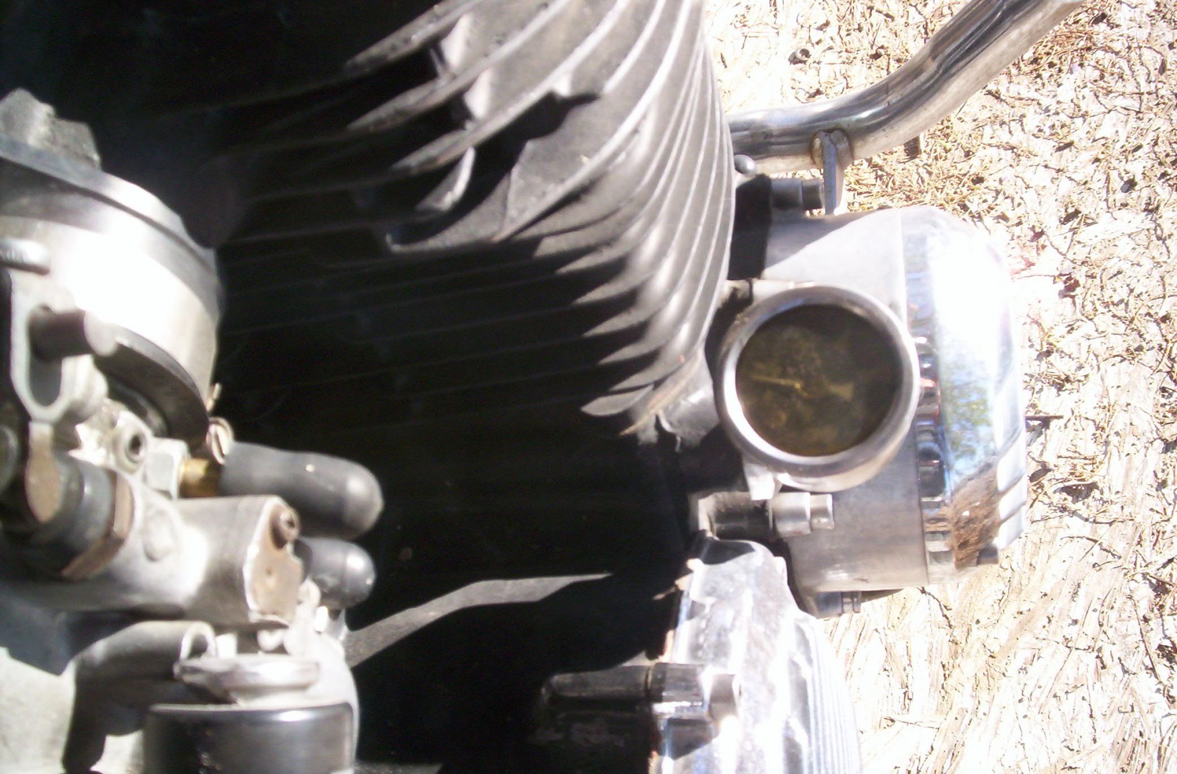

When the engine is cold and i start up, ican barely See the oil in the sight glass being sucked by the pump and the glass being empty. Normal.
BUT, when the engine is VERY hot (Like after 15 min of traffic or slow slow running in the city) ,if i look to the sight glass i can see with the engine running a bit of oil in the glass, a bit more over the minum level.
Since this bike, as We saw, has NOT oil level pressure sender, but only oil level sender... Im worried about that. Im afraid i have Not enough oil pressure in that running condition.
After all, i have to say the engine seems to work perfectly even when is hot hot hot and i See this bit oil sitting in the glass..

Thank you martin, kind as usual. I know about oil level. With cold engine on the centerstand , Not running, oil is at max in the glass.
You say its normal to See some oil sitting in the glass with engine running?
When the oil is still cold and i run the motor, the sight its empty and this is OK. I wonder if what happen with hot engine is good or is a oil pressure/delivery problem.
Im referring only to what i See when the engine is hot and running.

Oil level go down when i start. And when engine is running the oil disappear from the glass.
This chance when the oil is very hot. When very hot i can See a bit of oil on the glass, Like the pump have difficult to pump the entire amount of oil. And this is my question.

On my bike the oil level goes down in the sight glass when the engine is running & goes back up when it is stopped.

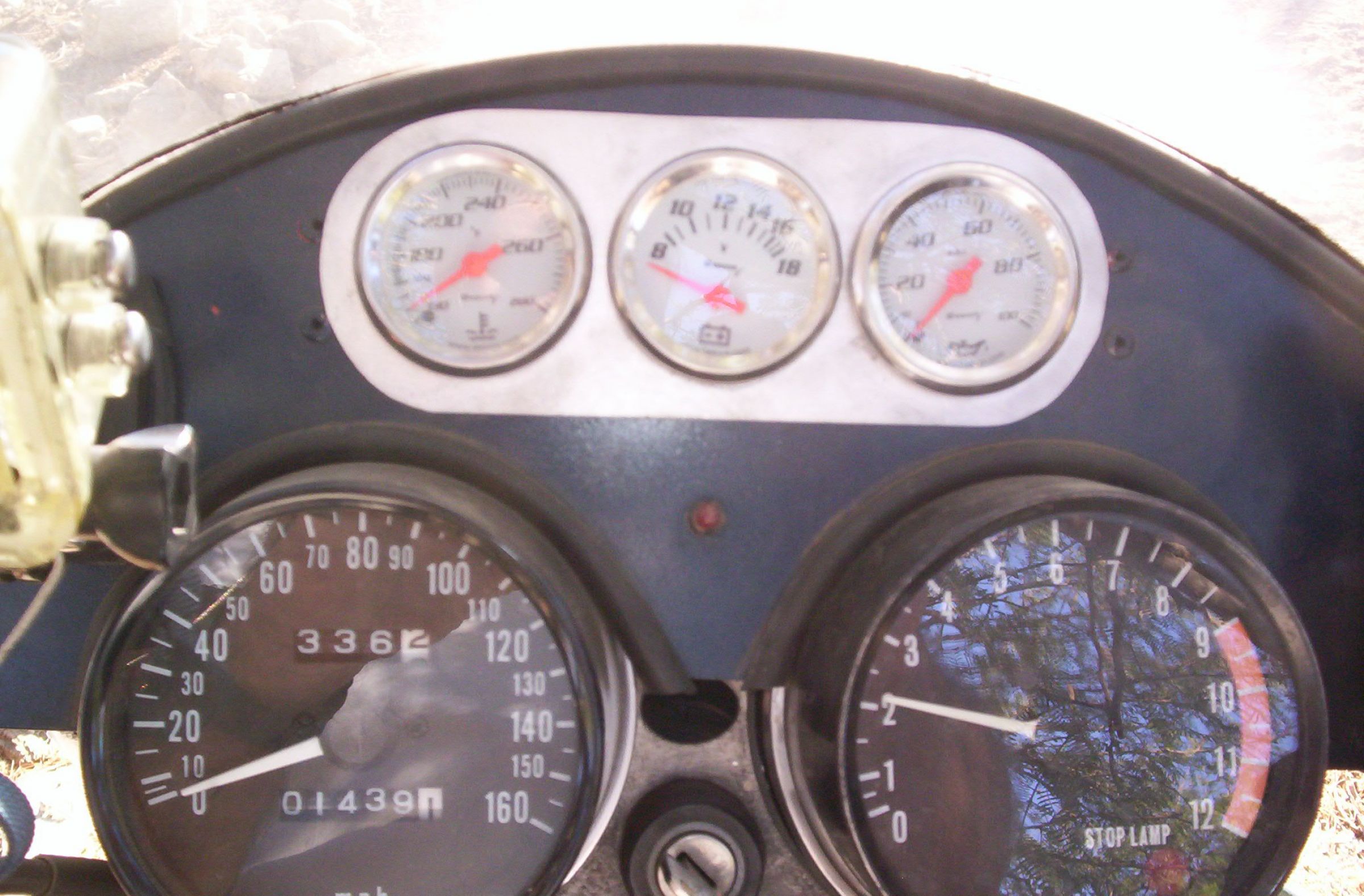

I never liked "idiot lights." In all my vehicles if they don't have a gauge, I install one. My daughter came out to visit and I checked the oil in the car I bought her. 04 Malibu. NOTHING on the stick. "The oil light didn't come on" she said.
I told her to check the oil at every fill up. The switch can be bad, the light could be burned out, whatever. I lunched a piston because I was burning more oil than I thought and the sight glass was dirty. I cleaned it and I now have two gauges.
In my 69 Ford F250, the gauge will read low when the oil level is low. The light won't come on until there is NO oil pressure. Same with the bike. Plus it gives me piece of mind when I glance down while running it hard and seeing high oil pressure.

I have never bothered looking at my sight glass when my engine is running. But it seems reasonable, as suggested, that the oil level will go down in the site glass with the engine running because of it being dispersed all the areas of the engine.
As for why it reappears after the oil gets hot? I am going to guess that oil takes up more volume when hot than cold. And that is why you maybe seeing it again once it is hot. I have no idea, just food for thought.

Just a reminder
OIL Expands when Hot
This alone can increase the level in the sight glass
So Cold oil in a engine Not running will be high since oil is not being pulled thru the motor
Once started the oil will go down in level as the pump pulls oil into the motor
Once the motor is hot the oil level can increase . But I will now guess as to not as high as it was cold and not running
Just some thoughts
