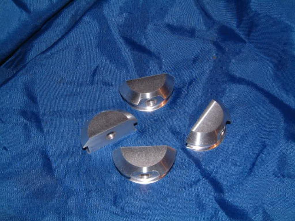

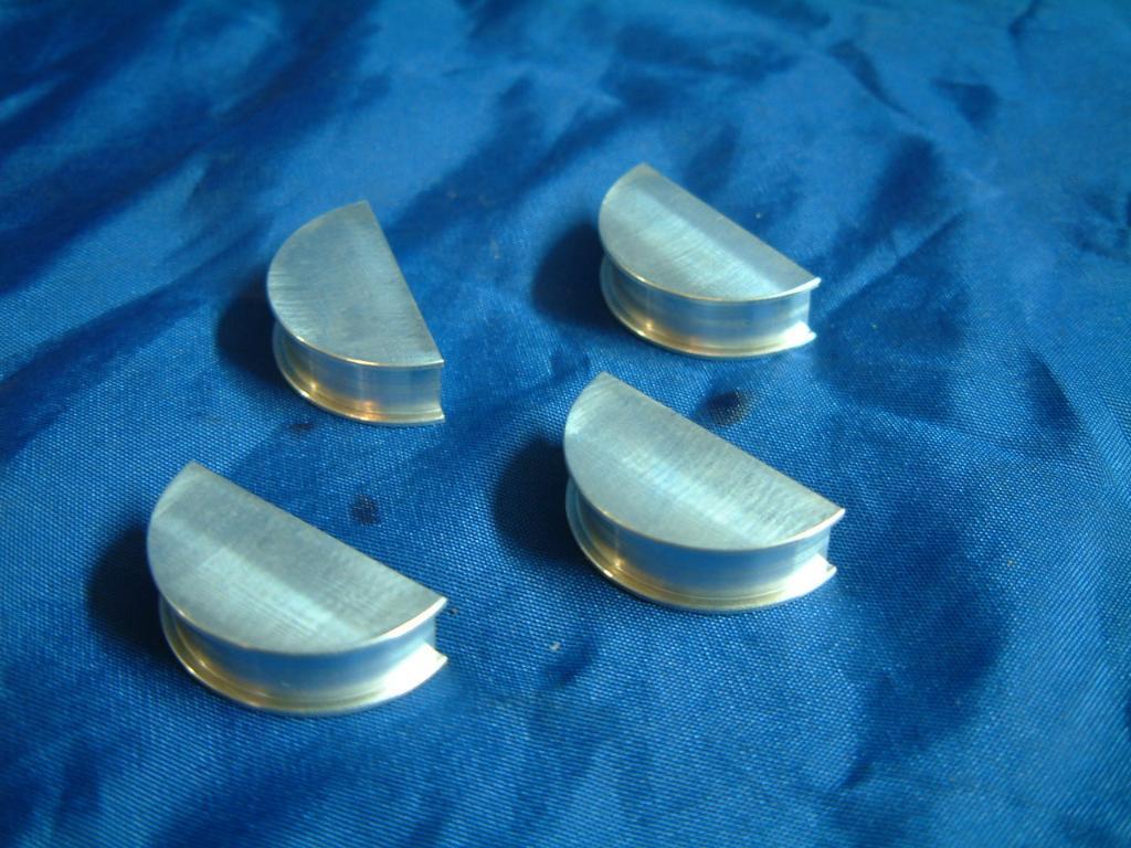

I use cam end plugs out of pure Aluminum, no rubber parts or mix of aluminum and rubber.
Build in with a light coat of liquid gasket and i have never leaks again after a valve clearance check!
Here in Germany cam end plugs are called "half moons".

I'm seriously considering getting those aluminum plugs too. I don't see why those rubber plugs are there in the first place.
Any ideas of the rubber plugs' purpose???
