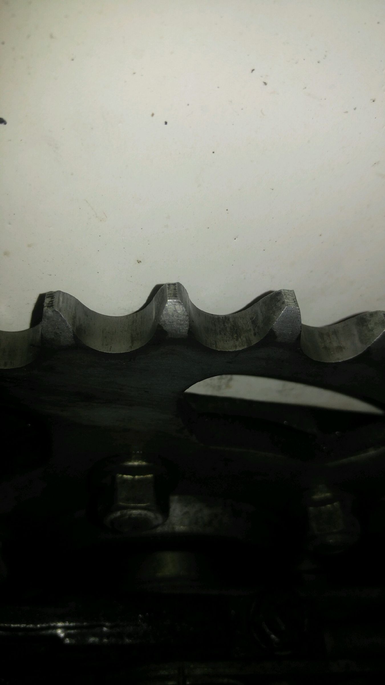

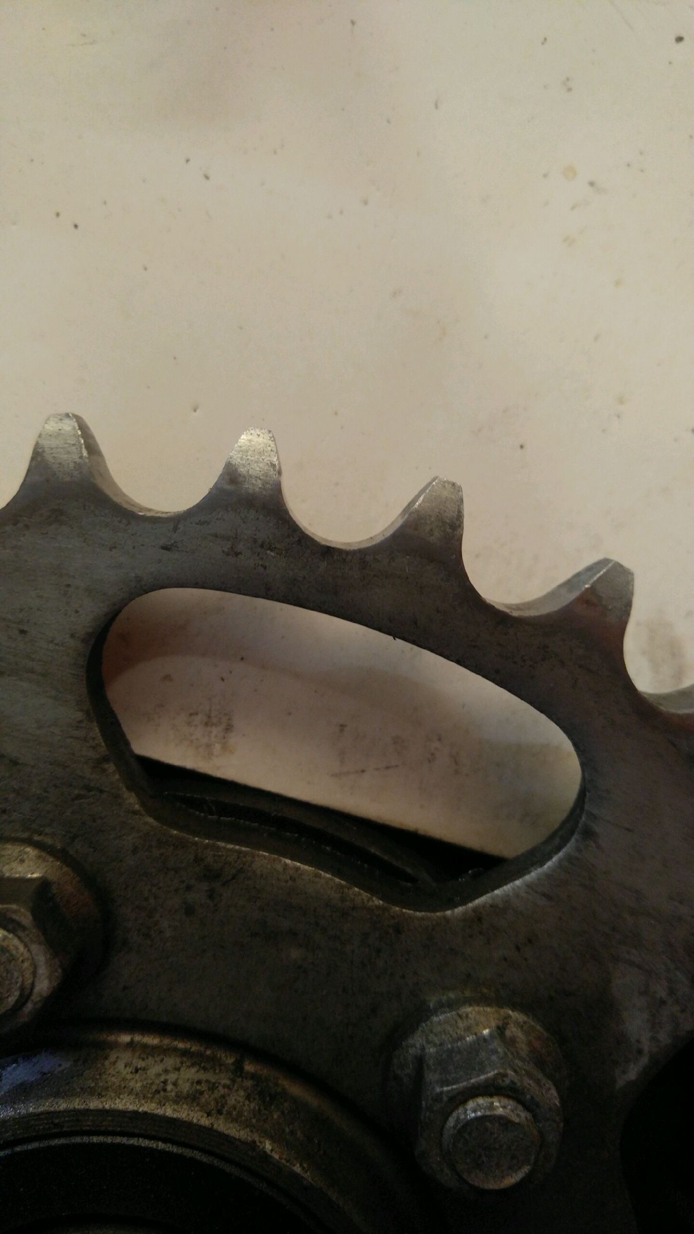

Re: Sprocket and chain choices kz900/1000
24 Jul 2016 13:02
Shelbyville, Indiana. '80 KZ1000
No more of that talk or I'll put the leeches on you, understand?
24 Jul 2016 13:20
Mine looked like that. Could hear slapping noises with a new chain and front sprocket no matter how I adjusted it. I found if it was way loose, the noise would go away. When I got my new O ring chain, I bought both sprockets. 1000 miles and no noise. Haven't had to adjust it either.
I'd buy a new one and save that one for lean times.
- MadShad
