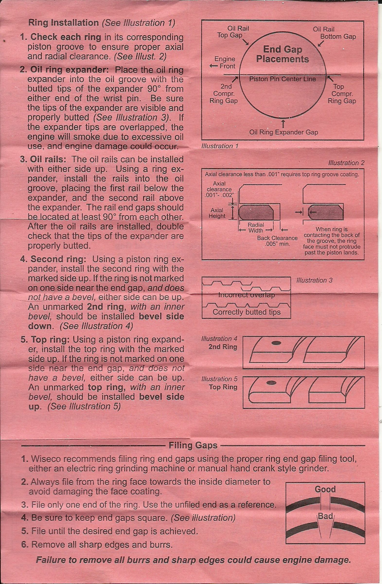

yup you are the man stripped her down and your definitely right mate they shouldnt be lapped . wish i was on ere before builiding it coz i searched the net for how they went but only got may may not depending on shape of the ends which on mine looked like lappers but now ive tried em in the bores its so obvious so ive manipulated the ends to butt together better hopefully this will sort it im optimistic just waitin for head gasket now thanks mate

ok so ive rebuilt her again after creating a butting end to the oil rings and she doesnt smoke any where near as bad just a tiny bit which i put down to not being run in .thank you for the advise i really apreciate it mate good man
