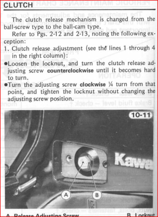

Did you replace the cable or adjust the clutch recently? And do you have the owner's manual --- it should have the correct adjustment procedure. I'm not sure about the your police bike, but on some models you're supposed to turn the clutch release adjusting screw counterclockwise first until hard to turn, then clockwise 1/4 turn.

Cleaning the release mechanism and lubricating or replacing the cable is the usual fix for this. Martin is correct about the procedure. Here is the blurb from the 1982 Supplement to the 1981 FSM---
