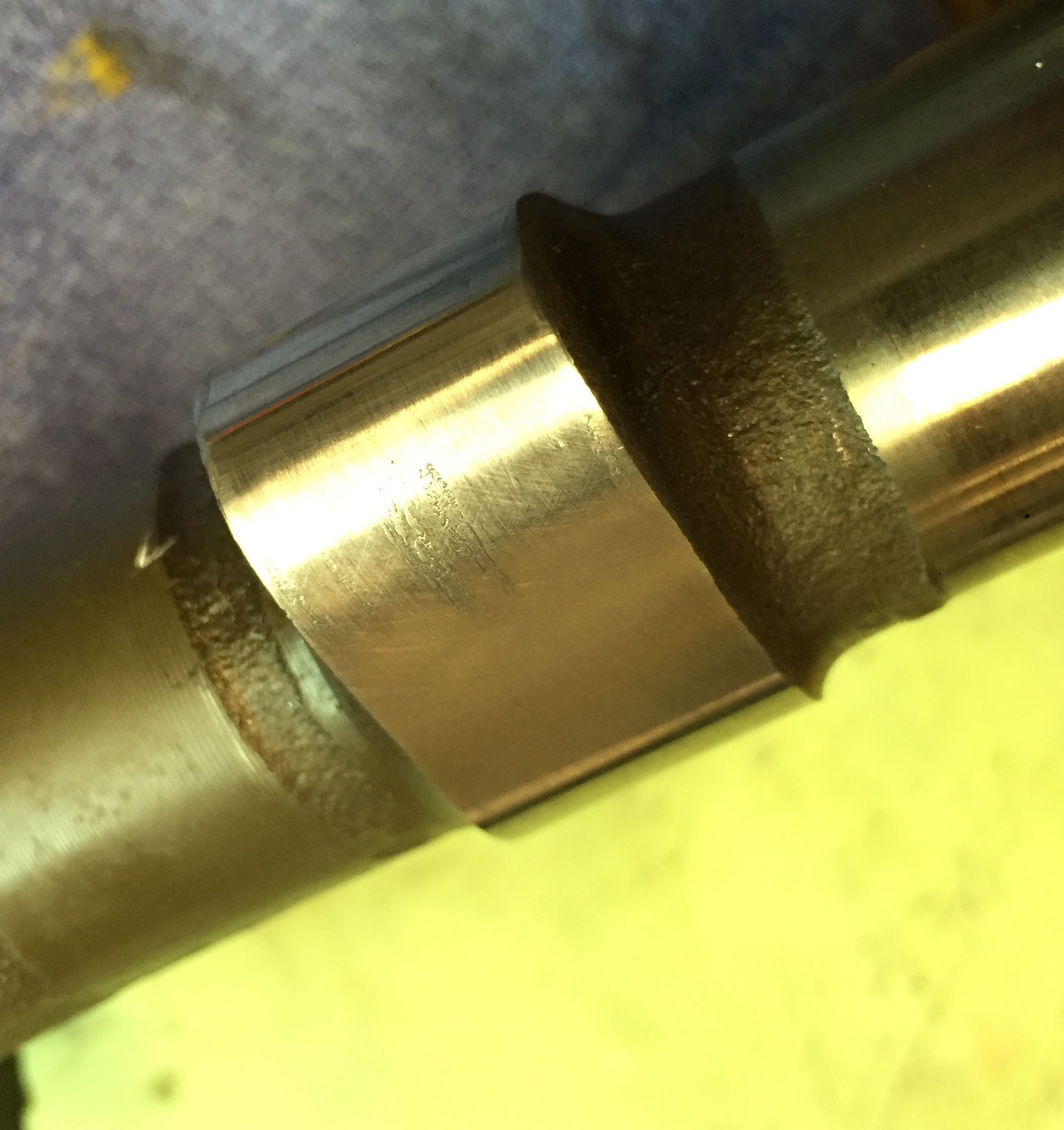

10 Jul 2016 18:20 - 10 Jul 2016 18:34Not liking some of the scoring on my cam lobes.
Under 45,000 miles and doesn't seem like I should be seeing these.

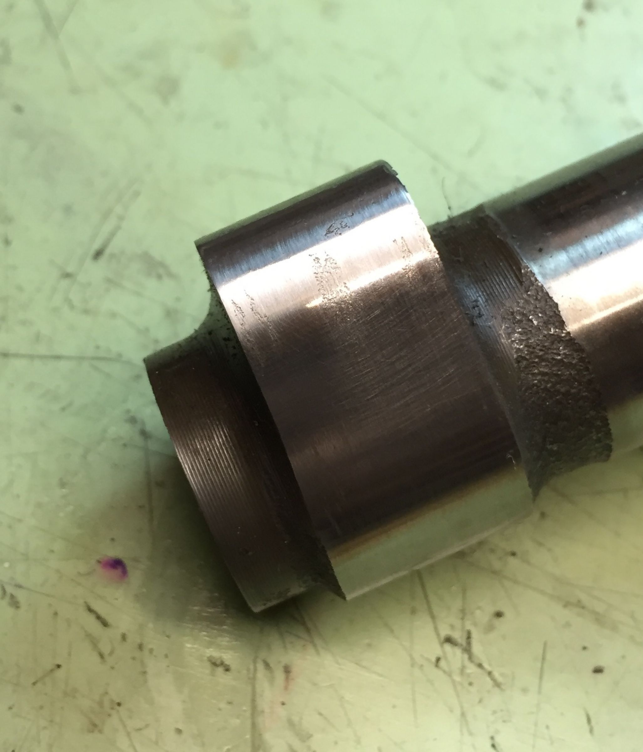

Re: Fouled lobes?
10 Jul 2016 18:33 - 10 Jul 2016 18:37Intake cam.
Same one with the bent valve earlier this week,
Two lobes scored and the two shims are scored also.
Stock, these are my original 77" cams.
This shot is lobe #3 intake.
You have zoom in to get a good sense of the scoring.

10 Jul 2016 18:45 - 10 Jul 2016 19:10
Those cams will run fine but I'd monitor the wear carefully. Some of Kawasaki's rocker arm engines ate their cams and the engines seemed to run well regardless. Such wear is a good reason to run good oil; something with a good bit of ZDDP.

11 Jul 2016 22:29
That's the kind of lobe scoring seen in cases where the oil was too low on ZDDP.

Re: Fouled lobes?
12 Jul 2016 12:03
That is spalling. There were lots of bikes that did this back in the 70's and 80's. Use a good oil and if it gets worse change them out.

Re: Fouled lobes?
12 Jul 2016 14:54
I have good pair of 78 KZ1000 cams that are well within specs.
Looking them over with my lens shows none of that galling. I'll probably use them.
