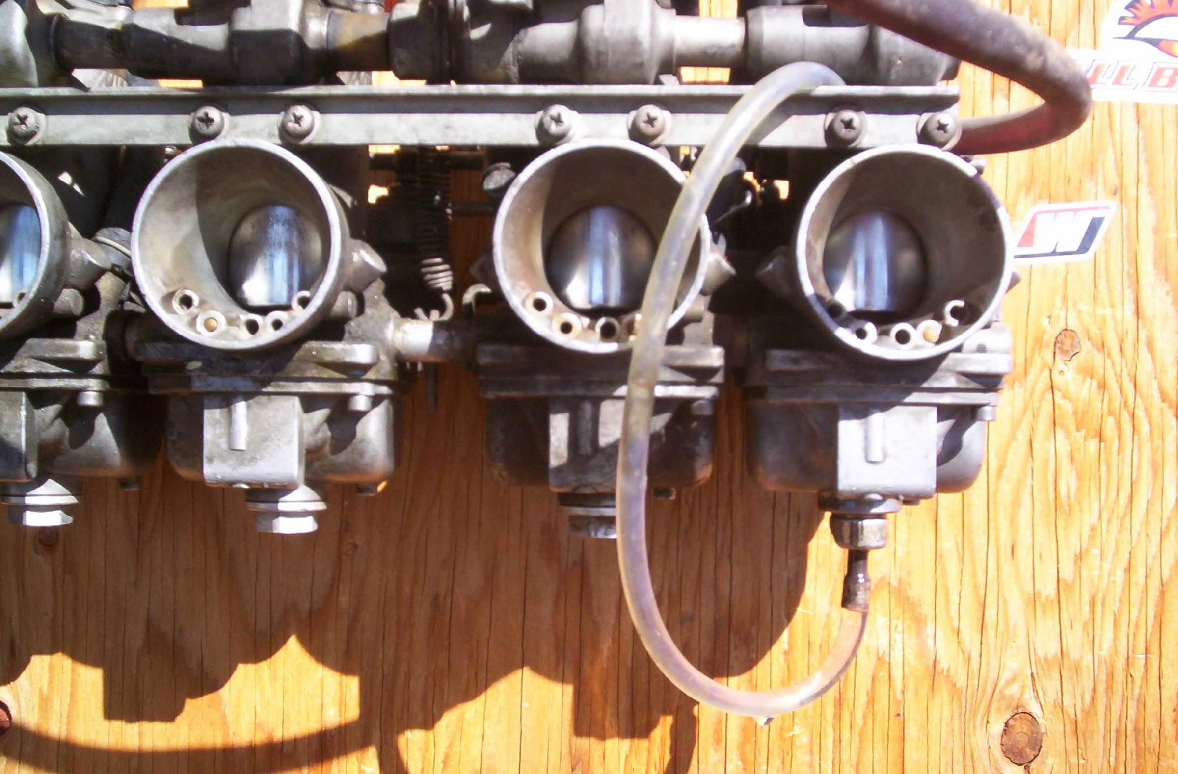

If you have some old carb holders you can screw them to a piece of plywood, attach the carbs to them, clamp the plywood in a vice and level the carbs, and then do the clear tube thing. Ed

Excellent idea Ed!!!

Re: 1978 KZ650 Smokin in the boys room
10 Jul 2016 18:34
That's pretty Awesome Steve!! Thanks for the pic!!

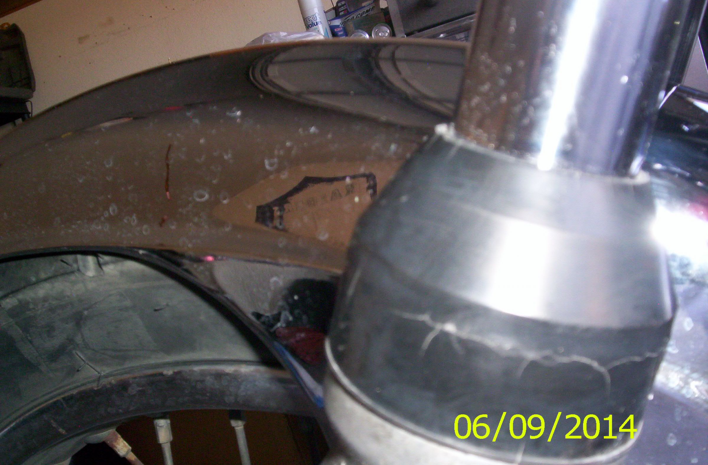

13 Jul 2016 06:10 - 13 Jul 2016 06:17That's pretty Awesome Steve!! Thanks for the pic!!
Sometimes you'll get some lousy advice.
Oil rings are probably stuck. Drain oil and fill 50/50 20W50/ATF.
Run engine, don't ride.
If you want to ride, use 50/50 mix of straight 60(from Harley dealer)/ATF
Some ATF is high in detergents that can damage seals and other parts. On a 30-40 year old engine the only way to stop them from leaking is to replace them. I use Viton valve guide seals and NEVER use NOS rubber parts.
This is what can happen to 40 year NOS rubber. This happened within a year of installation.
z1parts.net/z1-900-h2750-h1500-triple-fr...k-boots-dust-shield/
I'll be buying a pair soon. This company has a 100% money back guarantee and I've been happy with their service.
