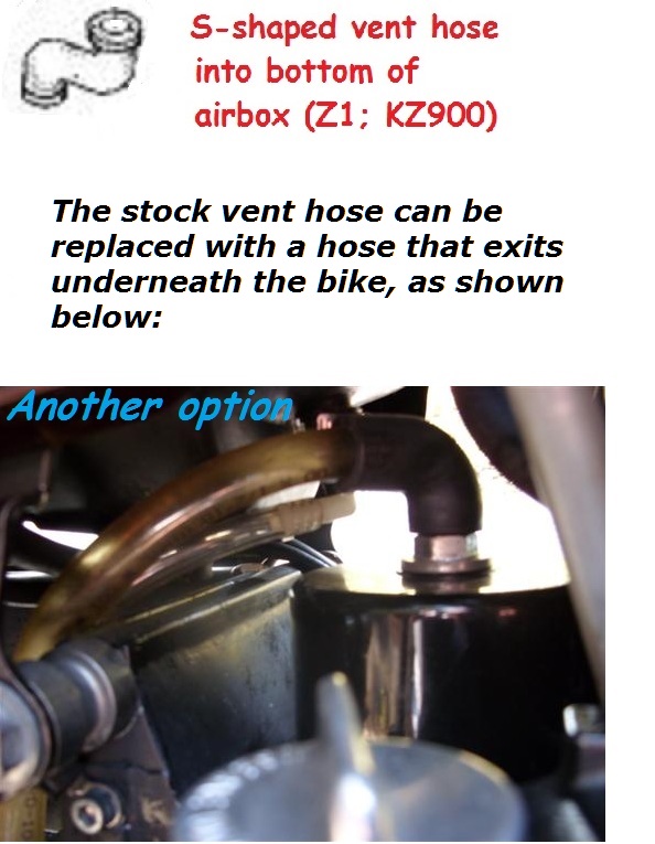

I see no oil spray coming out of crankcase oil breather top tube ?

The oil in the gas appears clear and kind of yellowish brown in color.
Should the oil breather tube have a filter on it ? I just left it open to vent into the atmosphere. And as I said when I swipe my finger over the vent tube, there's no oil trace. Nor do I see any oil spray inside the carburetor or engine area.

kzdcw wrote: . . . Should the oil breather tube have a filter on it ? I just left it open to vent into the atmosphere. . . .
Should the oil breather tube have a filter on it ? -- NO. Such filters are IMO worthless trouble-makers.
I just left it open to vent into the atmosphere -- That's just fine.
