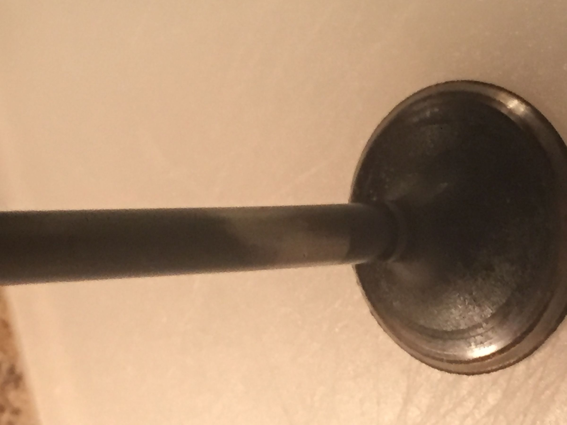

Re: Crap!!! Valves?
02 Jul 2016 19:40 - 02 Jul 2016 19:41
OK.... it's bent a very tiny amount.
I poured an ounce of mineral oil in the intake port and it runs right out the valve head and seat and on to my bench,
There are ZERO marks on the piston dome, and nothing marked around the valve head... !!??!
It did not hit the piston and it is not overheated.
It's just bent a little.
WTF? I wonder if the valve guide is boogered up or something.
This one is a mystery to me, yet it is off the seat a bit.
Enough that with my small, super bright LED light shining into the port, I can see light leaking out near the spark plug hole in the combustion chamber.
I am amazed how good condition the head gasket is and bone dry all around the cam chain tunnel.... if I was a cheap skate mofo, I'd consider reusing it... LOL
Also, some black'ish rich carbon deposits around the ridge area, so I'm changing the pilot jets back to stock in increasing the main jets a step up.

Re: Crap!!! Valves?
02 Jul 2016 19:49
I reused mine when I put the stock pistons two years ago. Didn't have copper gasket spray so I used silver paint like in the good ol days. Held up until I put in my 10.25/1 pistons and new one piece gasket. I'd use a new valve to gauge the guide for burrs or slop.

Re: Crap!!! Valves?
02 Jul 2016 19:58
