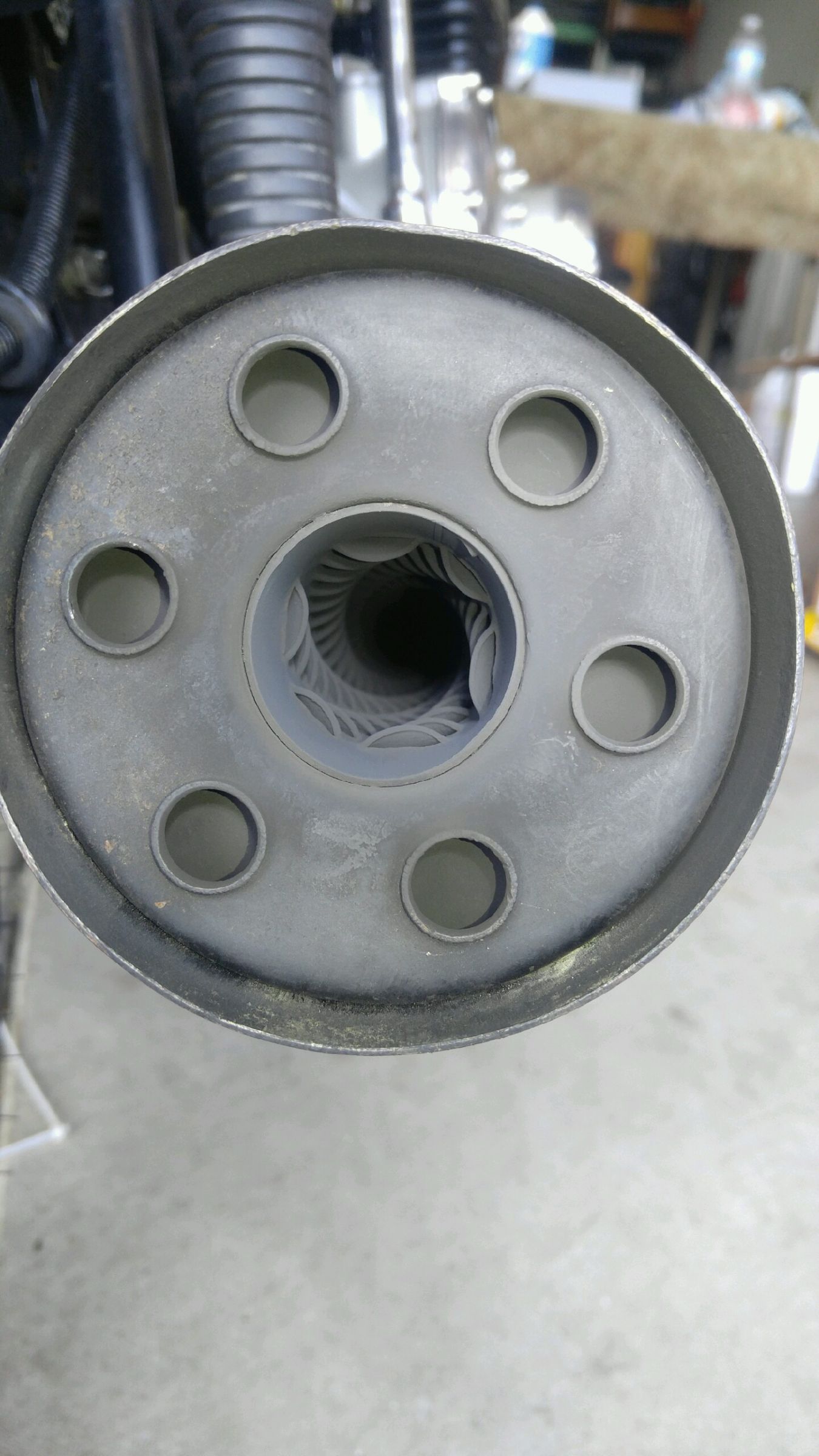

26 Jun 2016 07:35 - 26 Jun 2016 07:36So my bike is back on the road with a new Wiseco 1075 kit, putting break in miles on it now.
It has a vance and hines 4 into 1 megaphone on it with a rather large baffle installed, no packing.
The louvers of the baffle are in a spiral pattern and I'd like it to be just a little louder.
I had a kz650 with a V&H exhaust and baffle and loved the way it sounded, it had louvers that were stamped in a straight patten.
My question is what baffle do I have and what others are available, are all the megaphone baffles universial fit from the same manufacturer?
Thanks.

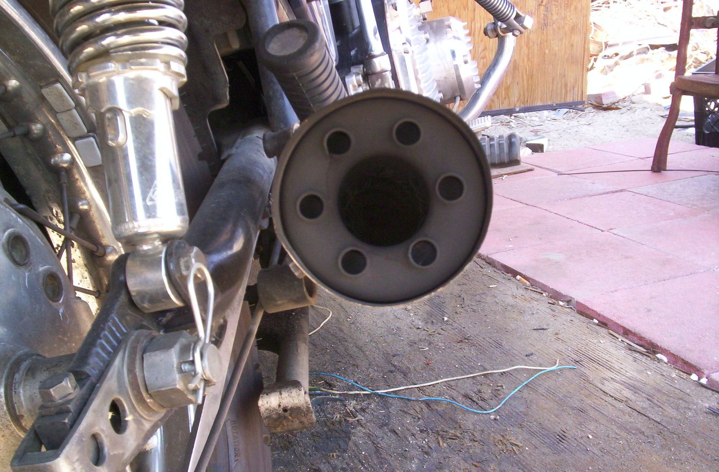

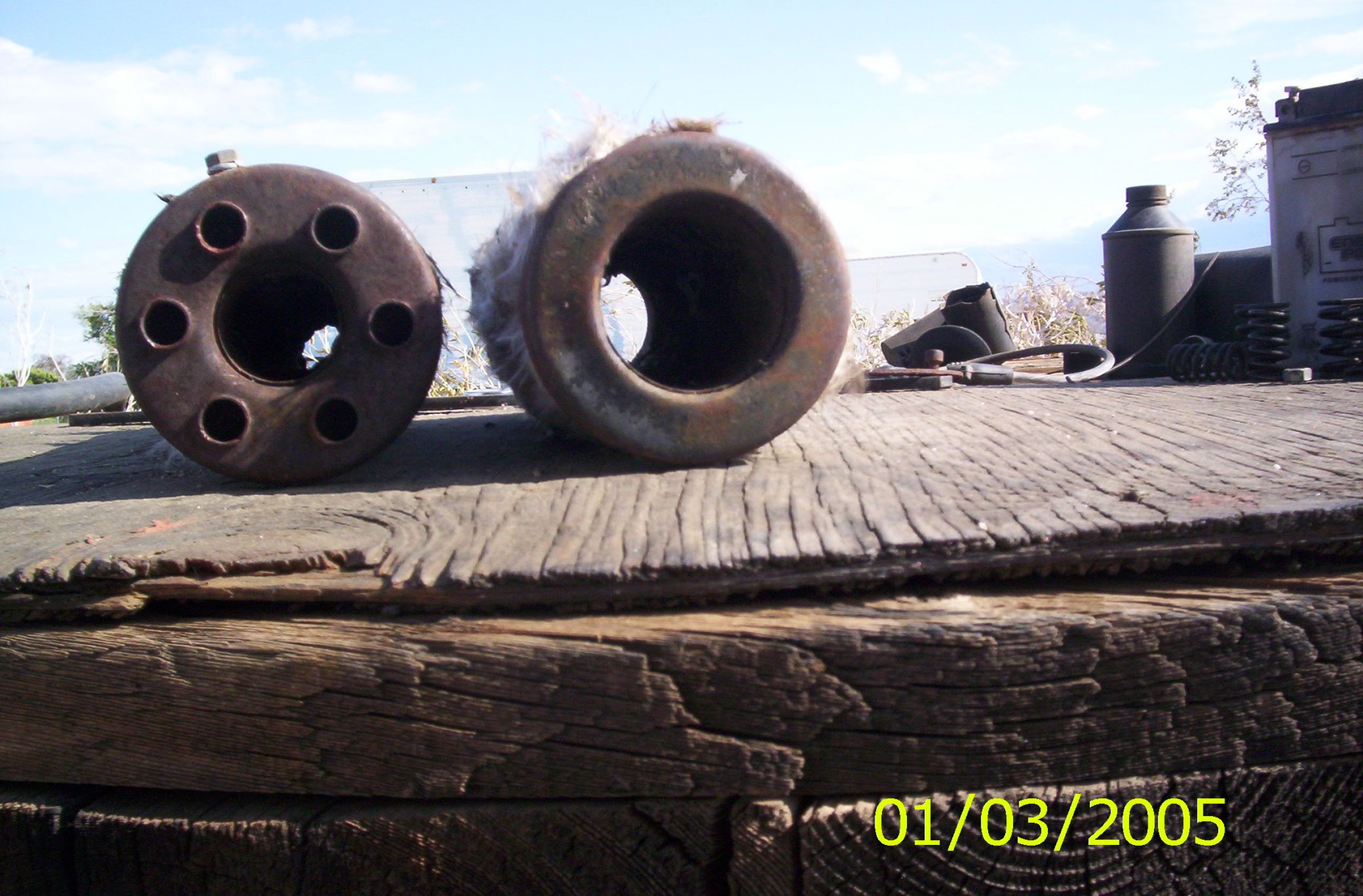

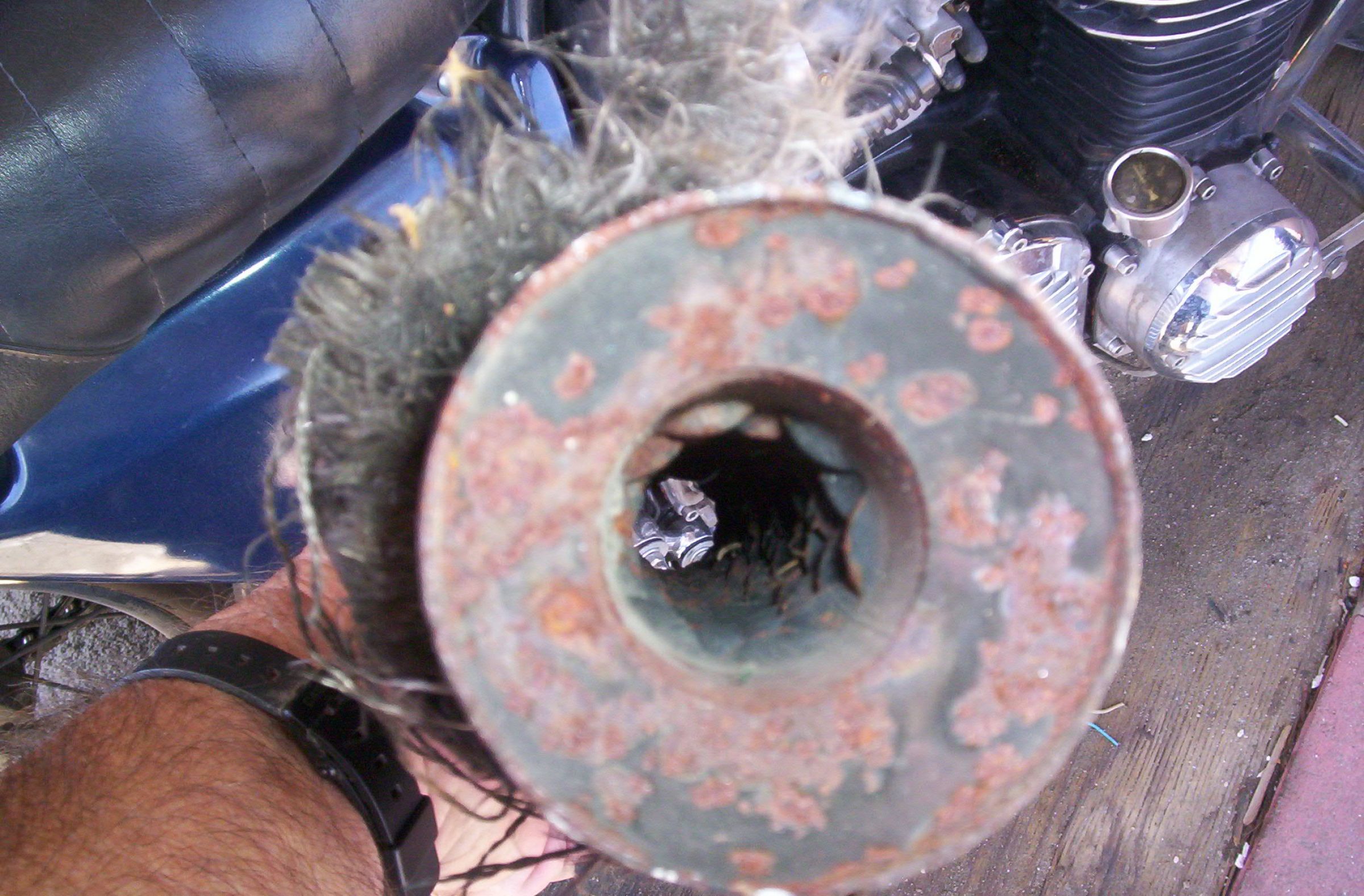

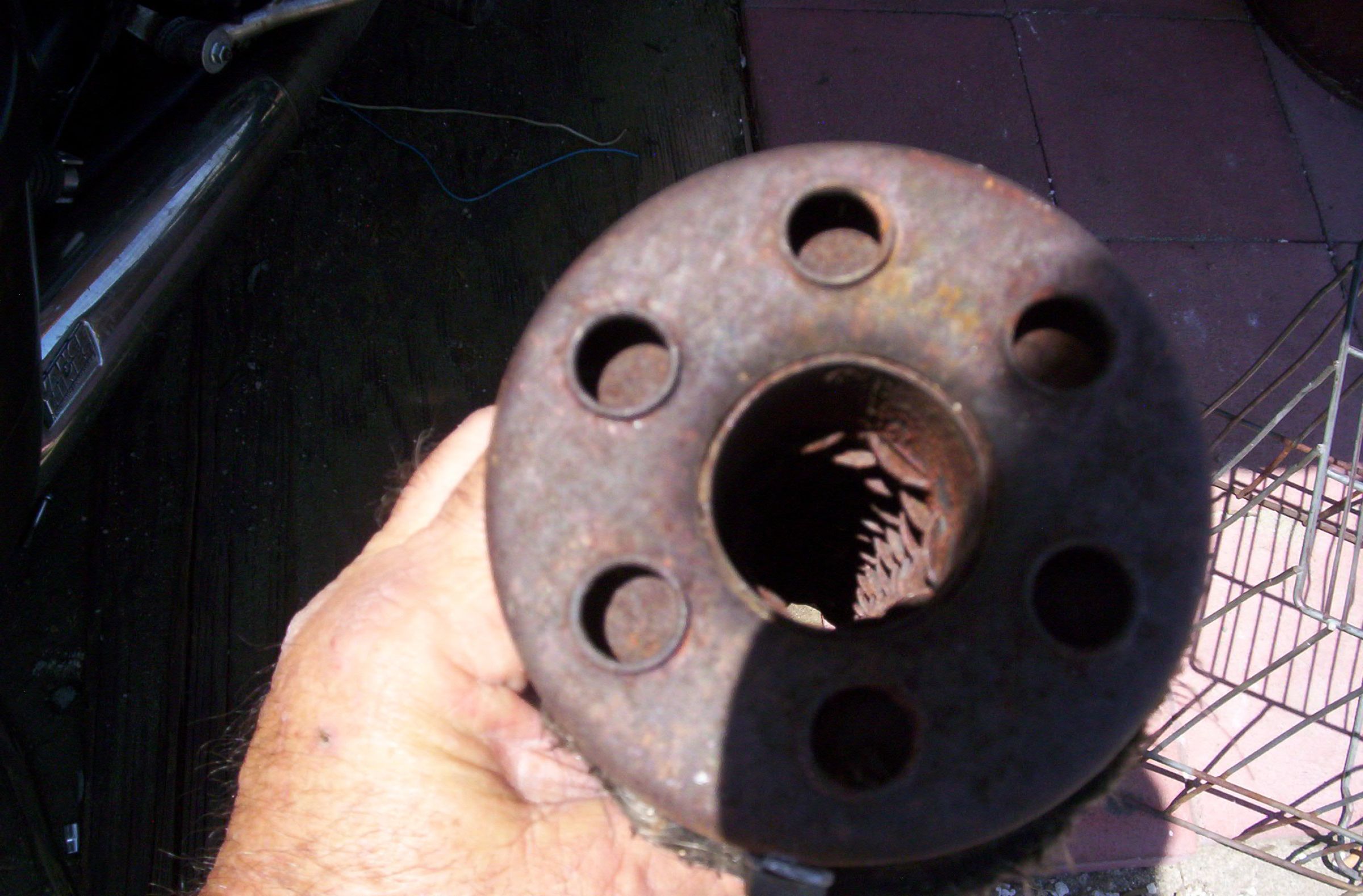

As promised here's some pics. The one you have looks smaller than the stock one I got with my 4/1. They made different models.
Competition baffle
Stock baffle
Competition baffle
Stock baffle

Thanks Steve, ya mine looks way smaller.
It's even smaller than the one I had on my 650.
Looks like I'm after the stock or comp baffle.
Is your comp baffle really short?

No, they're all the same. Been thinking on putting the stock one back in without the packing. The bike sounds great but I'm thinking I might get more mid range and better mileage with it. The drag one is way too loud and the top end fell on it's face.
