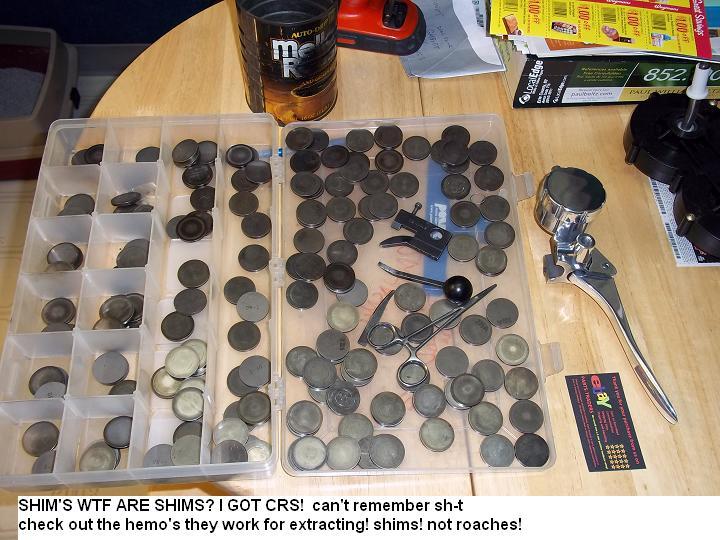

New Guys and Old Guys! This has been disgusted before many times!
#1 do you plan on keeping your Kaw for awhile?
#2 are you a cheapskate?
#3 can you put a price $$$ tag on a finger tip?
Buy the real tool! I did in 1977 from Kawasaki Dealer, I wish it was $49.
Mine works fine, but I wore the tip out slightly.
This is a 5 year old picture :silly: :silly:
