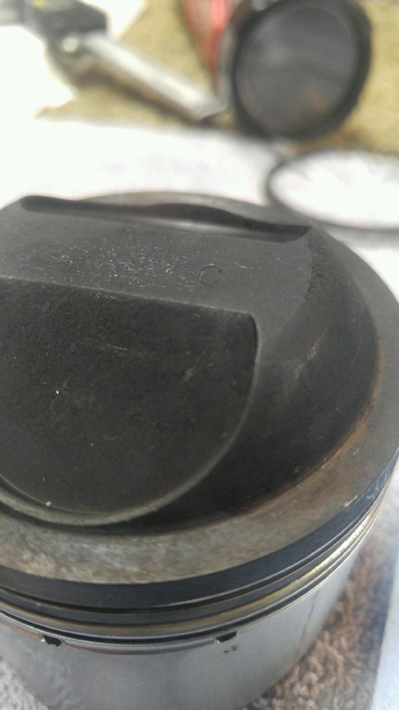

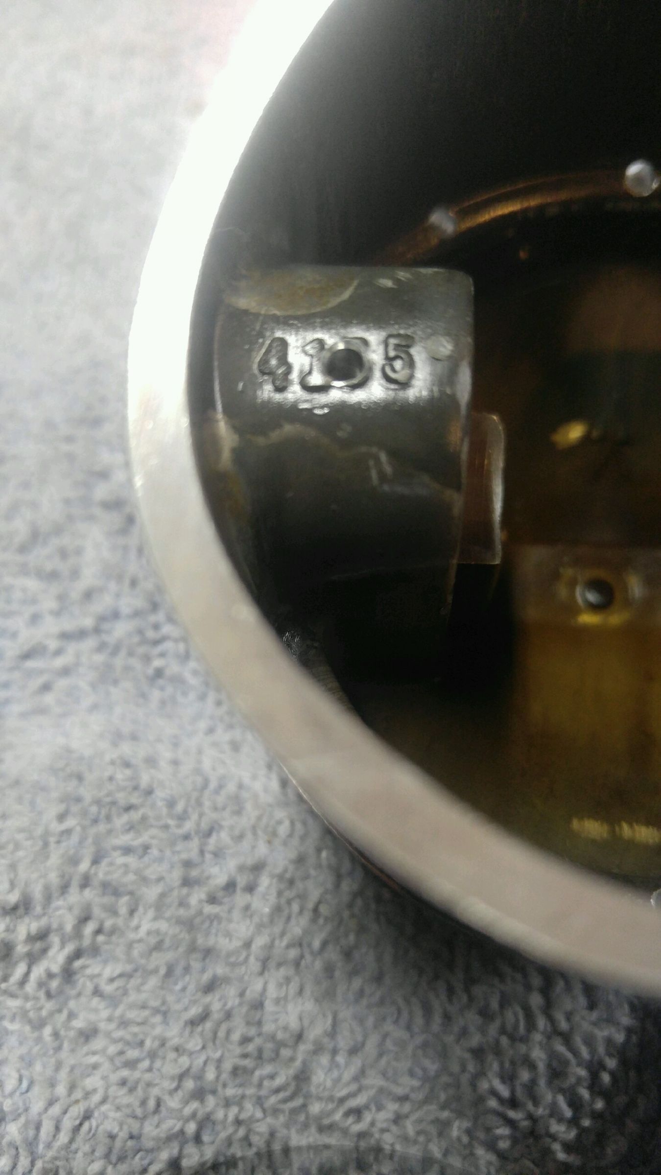

Kz1000, 1075cc set for 72mm bore.
Trying to figure out what brand of piston I have.
"C" stamped on the top
See pics for other markings.

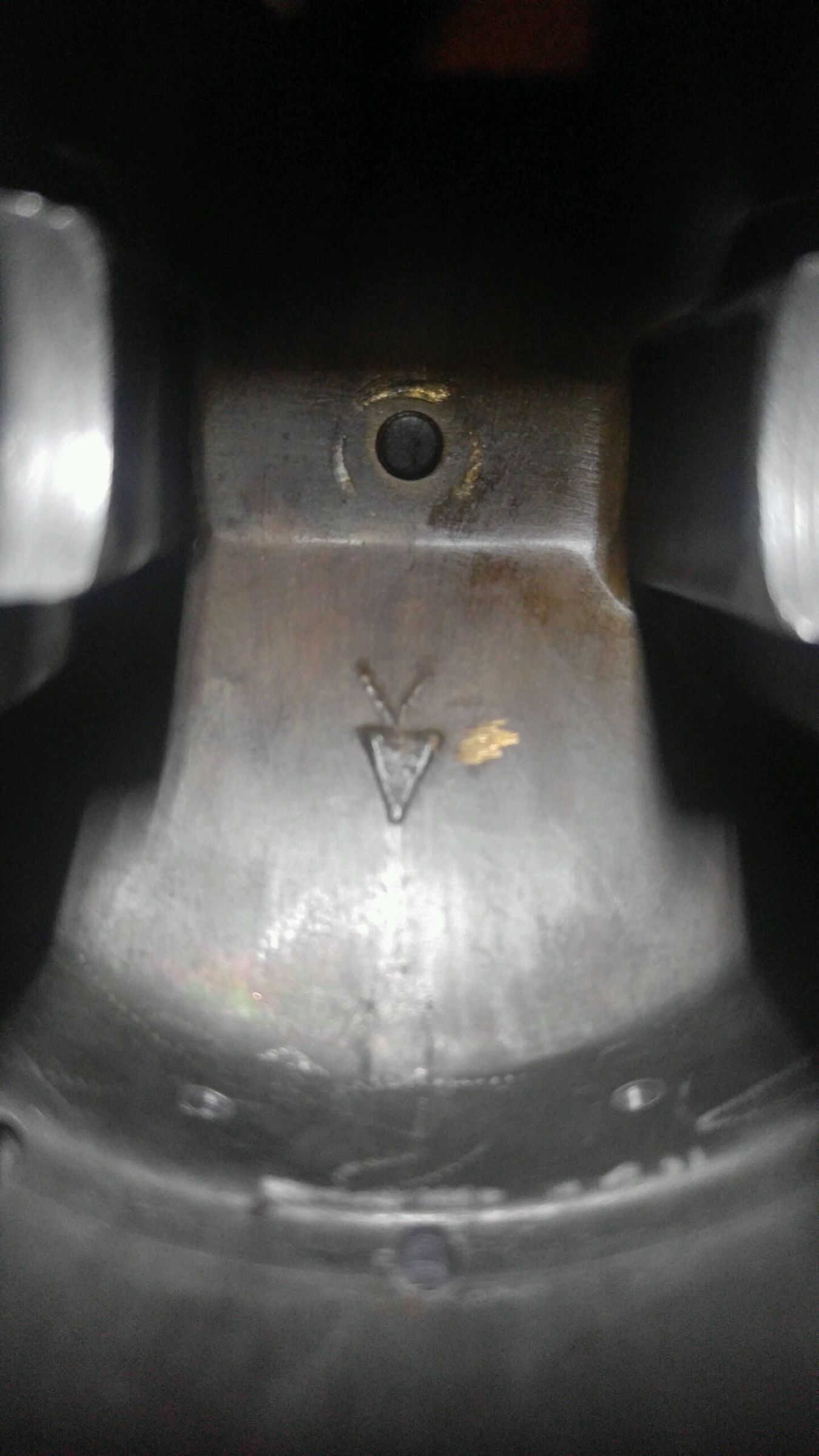

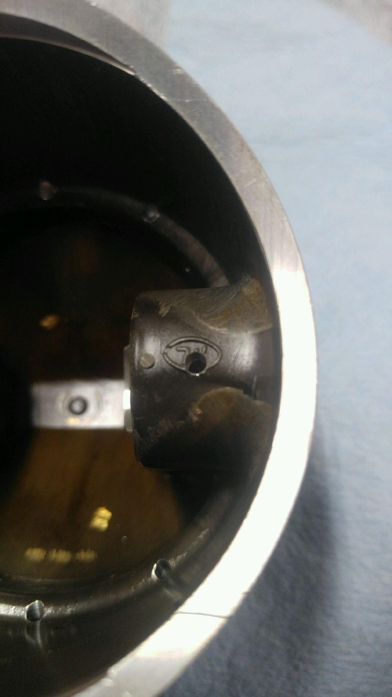

The funny looking w on piston pin boss,3rd from last picture.
Somebody spent some time/money on those pistons with the gas porting,Those pistons have some serious domes on them.

Ah, it looked like a 7 to me,
Wiseco make sense, the "C" stamped on the piston dome denotes the ring style apparently.

Yeah wiseco pistons are pretty easy to spot,No special skills involved in that one! :laugh:

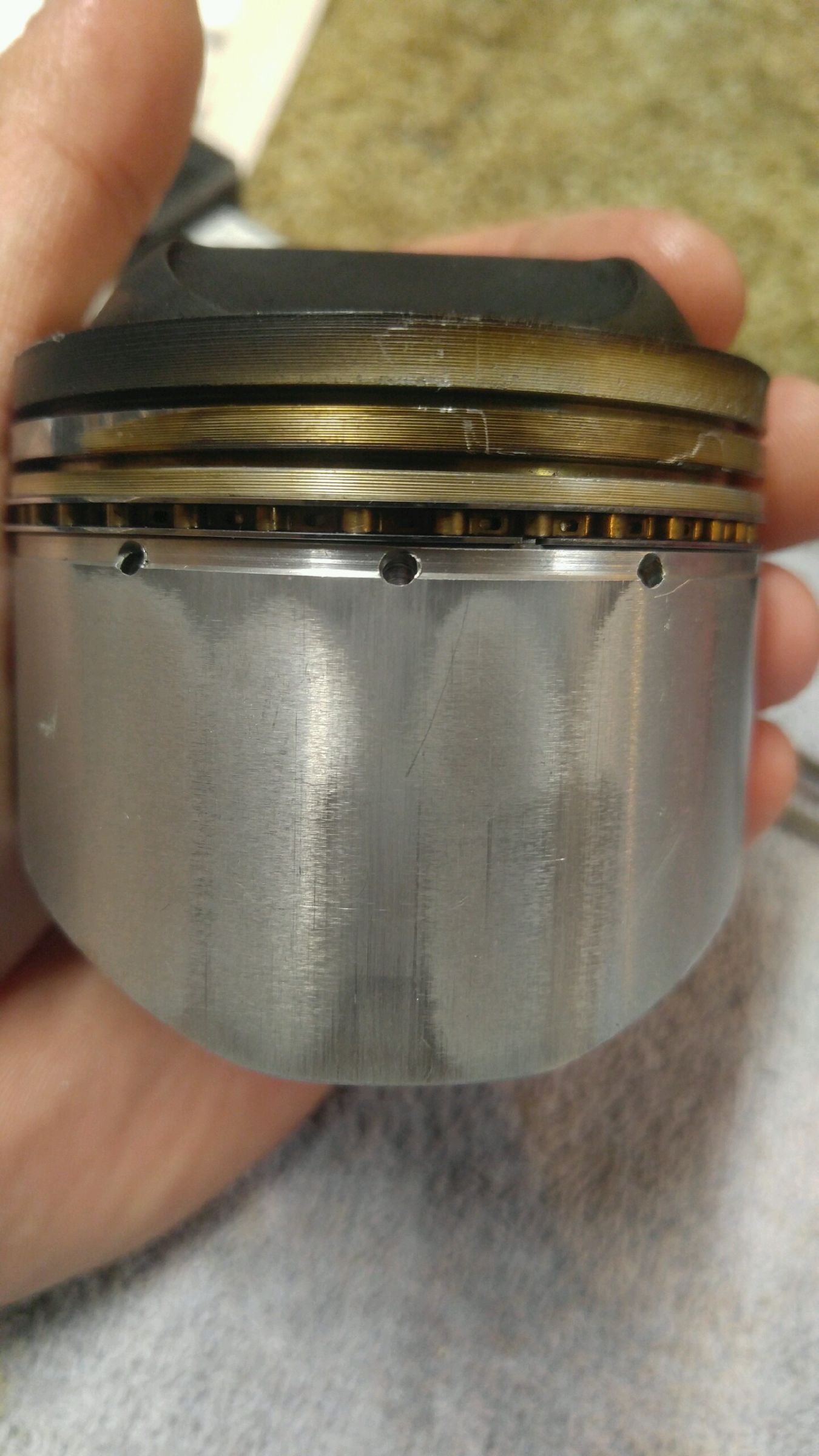

12 Jun 2016 10:06PLUMMEN wrote: Somebody spent some time/money on those pistons with the gas porting,
I can't see the gas porting. Where?

12 Jun 2016 20:45Thats what I call the holes drilled under bottom ring land.Nessism wrote:PLUMMEN wrote: Somebody spent some time/money on those pistons with the gas porting,

12 Jun 2016 20:54
Gas porting was done around the tops of the piston to force the rings out for a better seal. Never had the nerve to try it though. The holes on the sides are for more oiling. My cast Wiseco's have the same mark on the wrist pin boss so they must be wiseco's. The rings are the same for the old cast and newer billet versions.
