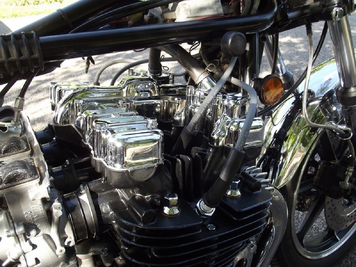

You can do what I did for the reed valve covers, like Tyler mentioned for less than 5.00,
, or you can get covers for them from ACE racing for 52.00 plus shipping
kzzone.com/resources/homethumbs/99211.jpg
Pete
Pete
