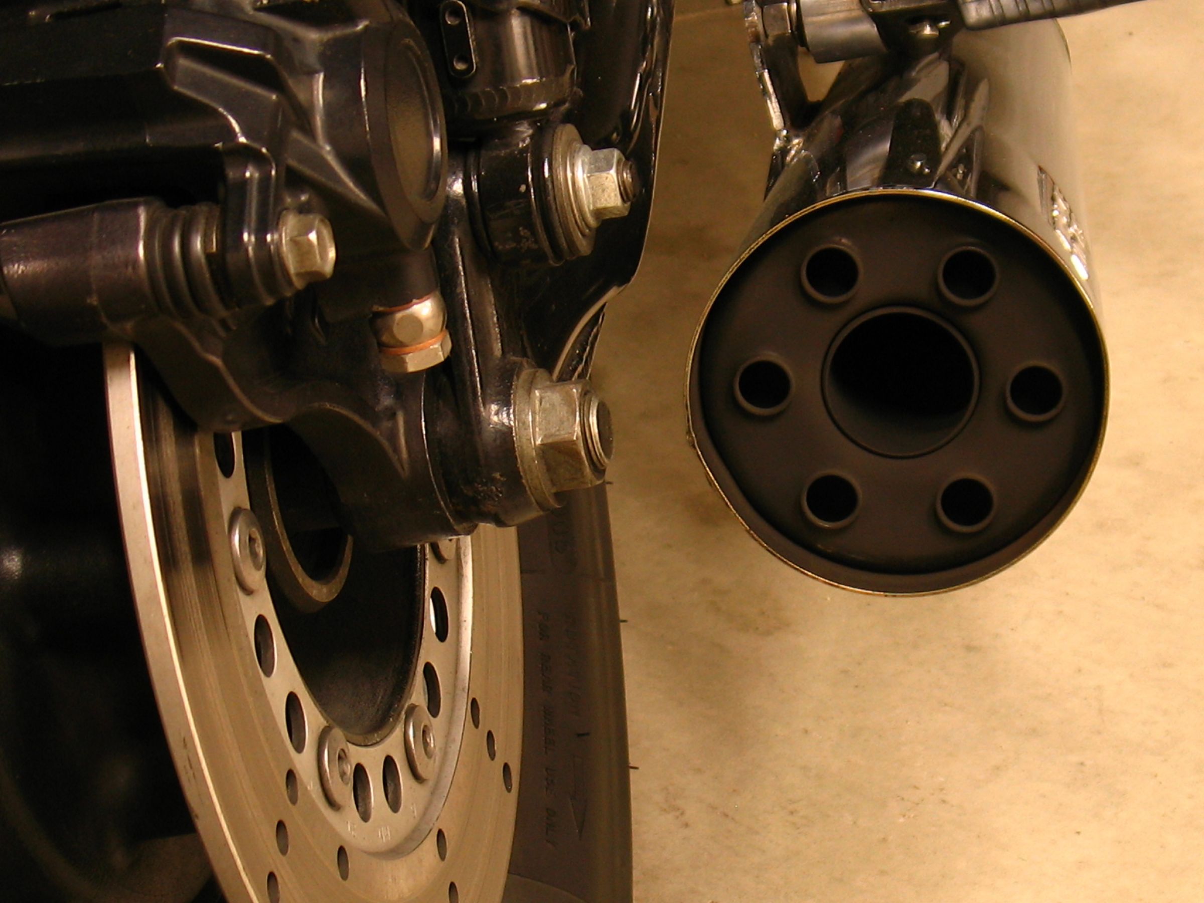

My carbs are getting close jetting-wise, I think. The spark plugs have that "peanut butter color", according to Steve (swest).
While looking at the tailpipe I now have that same coloration on the face-end of the exhaust baffle, and wonder if that reveals anything significant about the engine's state of tune? I never saw the tan coloration, before the RS36's were pressed into the manifolds.

It's running clean.
