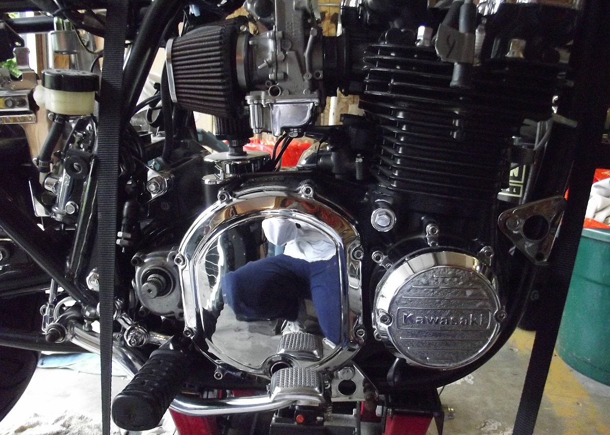

Like Martincsr & 650 ed said , you most likely over filled the crankcase with oil, & like martin mentioned you should run a hose from the breather, like he said, or get a K&M breather filter like the one pictured on my 1980 LTD 1000

Thats nice but were u have the filter i put one on but were would i run the hose from

Re: oil issues
17 Apr 2016 10:07The hose that martin_csr was talking about , you would attach to the top of the breather port, but you say you have a breather filter attached to the port, so what port are you talking about , that the oil is coming from ? can you take a picture & circle the port that your talking aboutgoldylox wrote: Thats nice but were u have the filter i put one on but were would i run the hose from

The port were i have the filter attached to is were all the oil is coming out but i think i over filled it and for some reason its not letting me post pics on here i tryed numerous times

Re: oil issues
18 Apr 2016 15:27Do you see the little round filter (that is sticking straight up) that is under the carb filters ..... (in the middle of Pete's motor) ..... is that where you are talking?
I got a little and a lot of ribbing from Steve and Patton about using one of these filters in a similar thread and am glad to see your running one Pete.
You say you think you put too much oil in...... put the bike on the stand or have some one hold it level and check the sight glass... if its above the top drain a little till you get it in the middle.......if after you get the level to this point and its still spitting out a lot out of this port like Steve says you have more problems maybe a broken ring or another cause of pressure build up.
