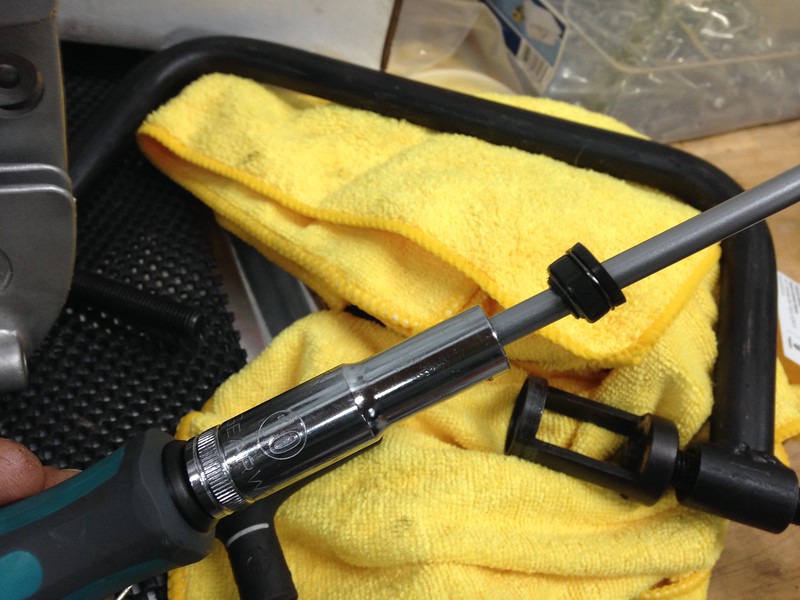

This is a technique from Nels (Noblehops) from a build thread.
www.kzrider.com/forum/11-projects/600077...-a-1975-z1?start=200
you can scroll down to this picture, he explains his way.
Use more than oil! Assembly lube or silicone grease. Yes, always be careful. And I always have more than 8 on hand. In case you trash one.
More tricky if you use the thinner Viton seals.
