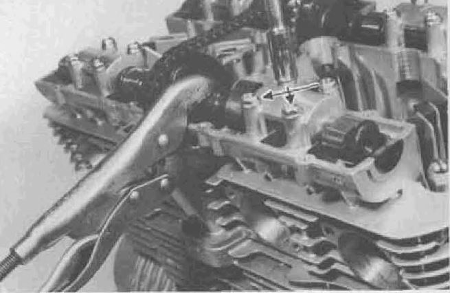

Using vice grips to clamp the cams down into the head is the way to go. No worry about stressing the cap threads that way. The following photo gives you an idea, only I recommend TWO pairs. One on each side of the cam chain.

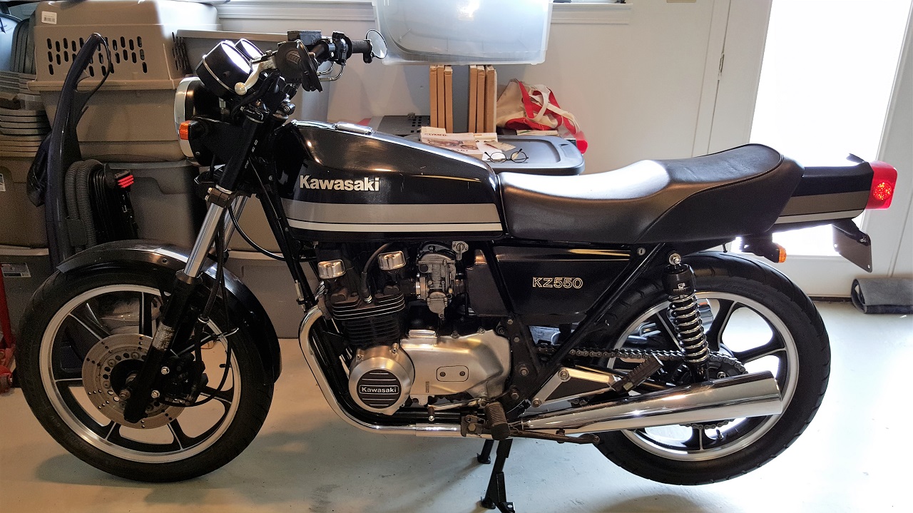

Since I had the valve cover on the garage floor for a week and had recently did some case buffing, I decided to buff-up the valve cover ends for some more shine:
Took the ol' bike out for a spin this afternoon after work and it really runs well now. I still have that bothersome idle even after a cleaning the carbs but once this engine is warmed up it pulls like a freight train downhill !
