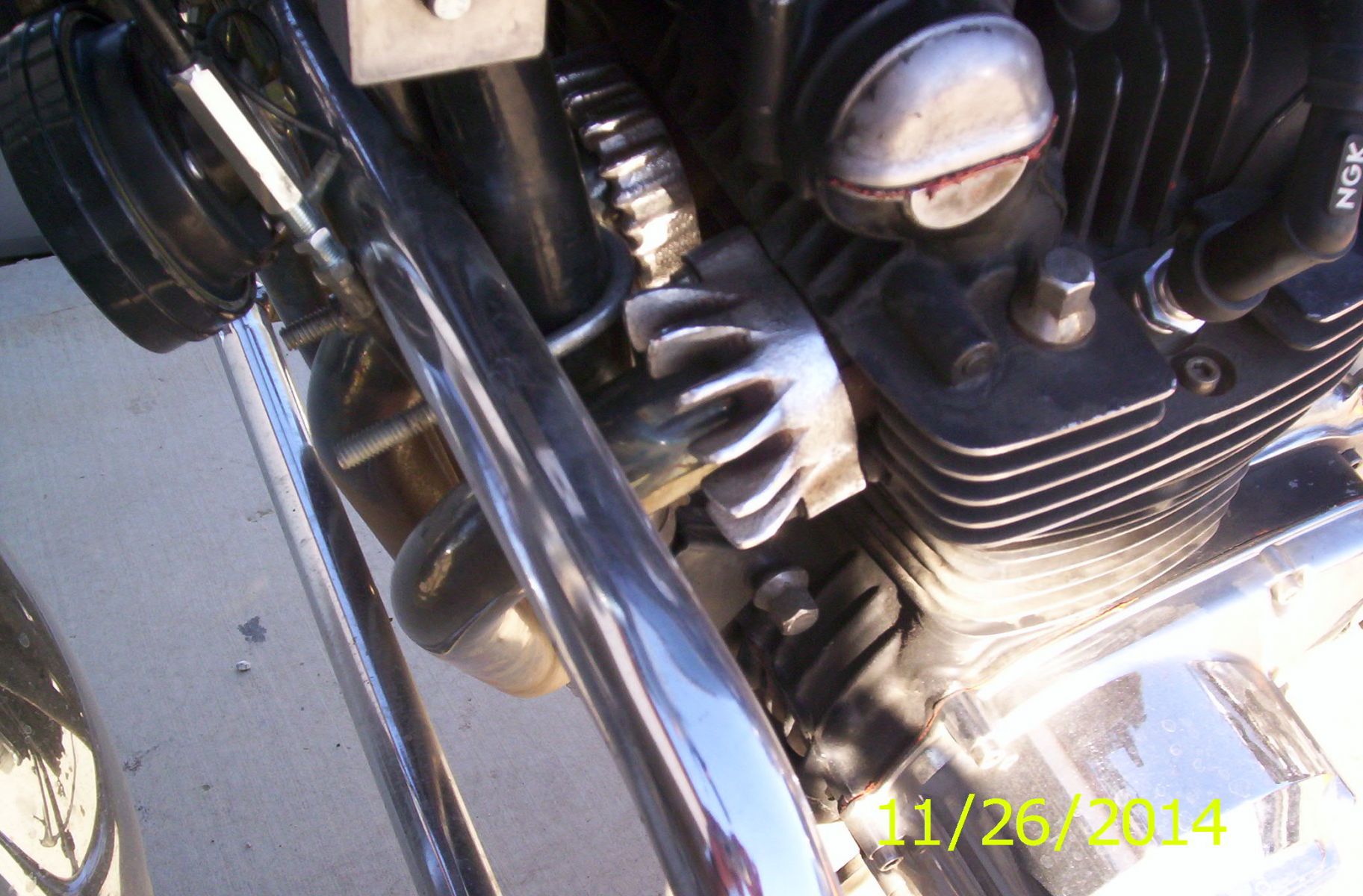

I have two susie flanges on mine. FOXY :whistle: I used # 10 aluminum wire as a shim. They are deeper than the stock ones. I'll be ordering some new ones soon but will still have to keep the two shims.
