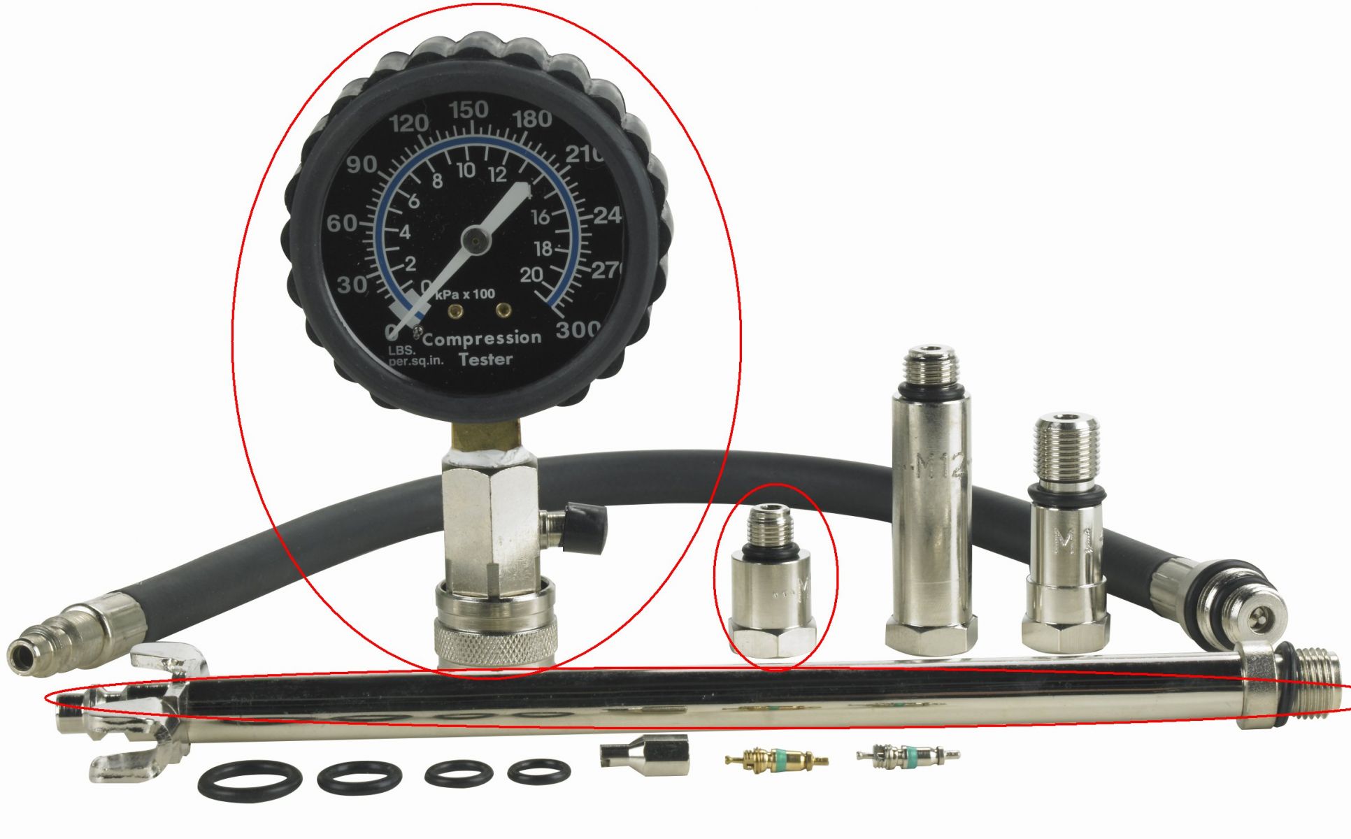

Lou - are you kind of insinuating that screw in types are inferior to hold in type? I always thought screw in were supposed to be better. Maybe I'll add another gauge to my toolbox as a cross check.
Kinda wish I could use the wife's old sportster battery...its almost new, fiberglass one and 220 CCA instead of the 160 or so I got...but the posts are reversed and it just barely doesn't fit... I did hook it up though last year and she sure turns over much nicer.

No. Screw-in compression testers can be just as good, if not better. But if the check valve is not in the tip that goes into the motor, then it's not good. Some have a valve all the way at the end of the hose near the gauge. This adds a volume to the "effective" combustion chamber, which reduces the compression reading significantly. In my opinion, those gauges are simply made wrong, and don't do what they are meant to do. I think it may have been Harbor Freight selling those around 15 years ago.
Some have a relief valve placed away from the tip. That is fine. A relief valve, (as long as it's not leaking) makes no difference. But there needs to be a check valve to allow the pressure to build up in the gauge. Without it, the gauge loses its pressure on every stroke. The closer the check valve is to the combustion chamber, the more accurate the gauge will be.

27 Jan 2016 10:57 - 27 Jan 2016 11:06OK, I think my gauge my be fine then. It looks identical to the one I have posted here. I do have to use the M12 adaptor to fit the plug hole though, which adds 4" of volume. If you look at the threaded end of the hose, there is a check valve there and the relief is on the gauge itself. So, that adaptor may influence my readings...but how much I don't know. If I remember correctly, the actual volume of the combustion chamber isn't all that much when the piston is at TDC, so the volume of the adaptor may be be 10-20% of the volume of the chamber (throwing numbers out for example), which would affect the numbers... It's been a while since I did the ol' P1V1=P2V2 (and assuming adiabatic), but if that volume of the adaptor is 10% the volume of the chamber and my reading is 140 psig, that means I could be cheating myself 14 psig, right?
