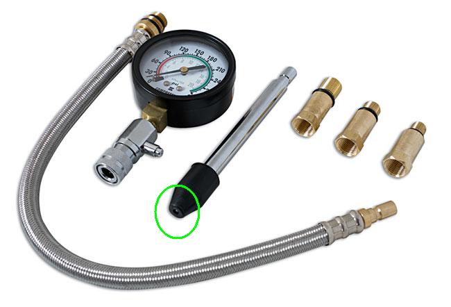

The valve stays put regardless of attachment. There is a sick connect fitting. 3-5 cranks and it pumps up. 180psi across the bank. R

On the hold in type, the check valve is also the relief valve.
With the attachment types, the relief valve is on the gauge end. But the attachment should have the check valve in the tip like this one.
