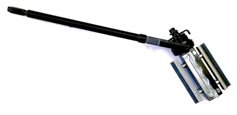

Guy that does my bore work will hone a cylinder for $5.00 a hole
with a Sunnin CK-10. He teaches a motorcycle machinist class for our
local comm. collage and hold's class in his shop so he get's paid to let the student's
watch and learn how to do it right.

A hone like that straightens the hole, but it also removes a fair bit of material and increases clearance between the piston and cylinder. For a used cylinder that's in decent shape, where you just want to deglaze the cylinder and install new rings, a flex hone is the proper tool for the job.

a dingleberry hone will work just fine for de-glazing the holes.
as i am a small engine machinist i have a sunnen adjustable hone,
the same as the head on the ck-10 except i drive it with a 1/2 drill motor and hold the cylinders in a vise.
they are fully adjustable and you can take as much or as little as you like.
when i am using it to break the glaze on a cylinder i adjust it and make only five strokes.
the glaze is broken and only a tenth or two of a thousandth of material is removed.
measured with a mitutoyo dial bore gauge.
thats my .02 fwiw,
p.s. i would say with a dingleberry hone that 10 strokes would be sufficient to break the glaze.
