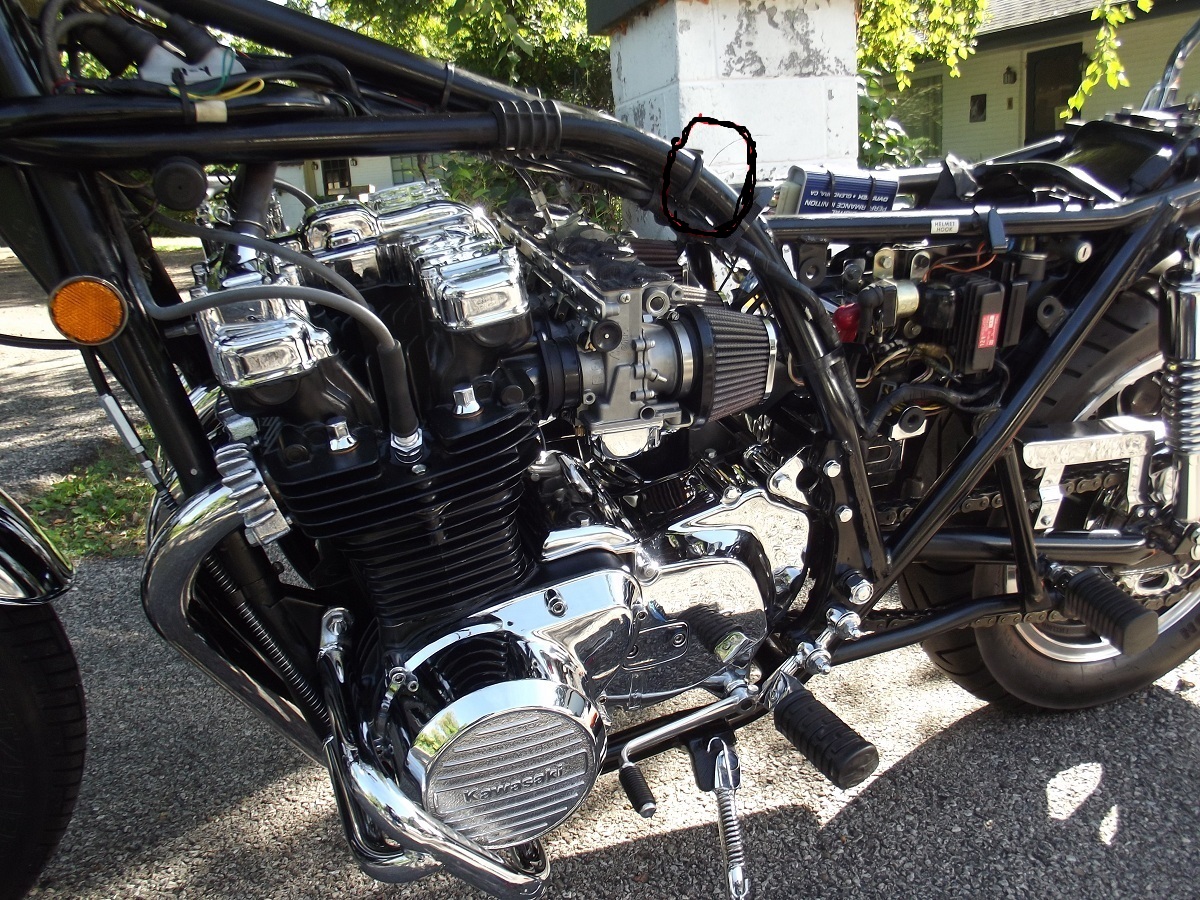

Jim from Redline Cycles used BBQ paint when he did my motor 5-6 yrs. ago
this is what it looked like back then & has held up well, so far
Pete

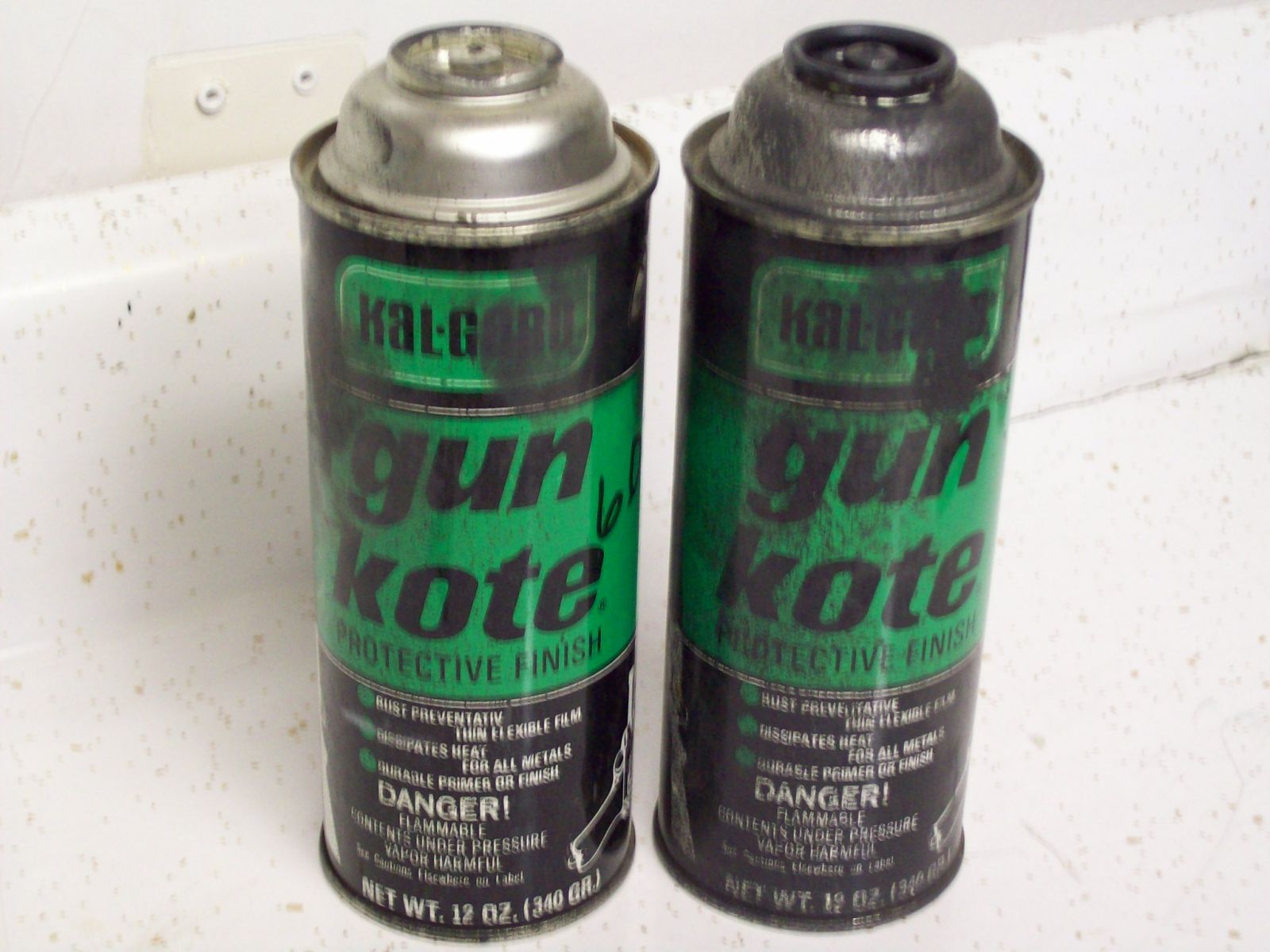

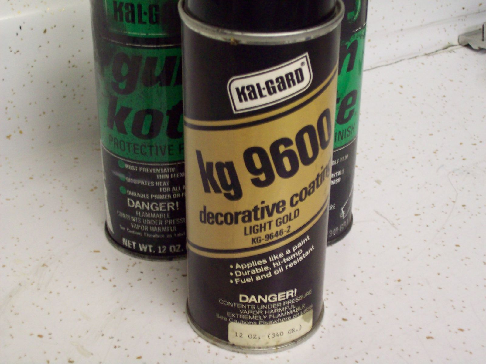

26 Jan 2016 09:02
I always got my GunKote in a rattle can from KalGard back in the late 70's to early 80's. GunKote was the nastiest smelling stuff that I ever used that came out of a spray can!!!!! Plus most of the cans never sprayed till they were empty. The cans ran out of propellant before they were empty. I never had a air brush back then, so I had to use the rattle cans.
The other product I liked from KalGard was their KG9600 COATINGS. It came in various colors. Their Light Gold is what Morris used to coat their magnesium wheels back in the 70's. It was applied almost like the GunKote was. I did many a wheel and engine cases with their KG9600 coatings back then.
I need to do a few motor parts in GunKote, and I wonder if KalGard still offers it in a rattle can??
