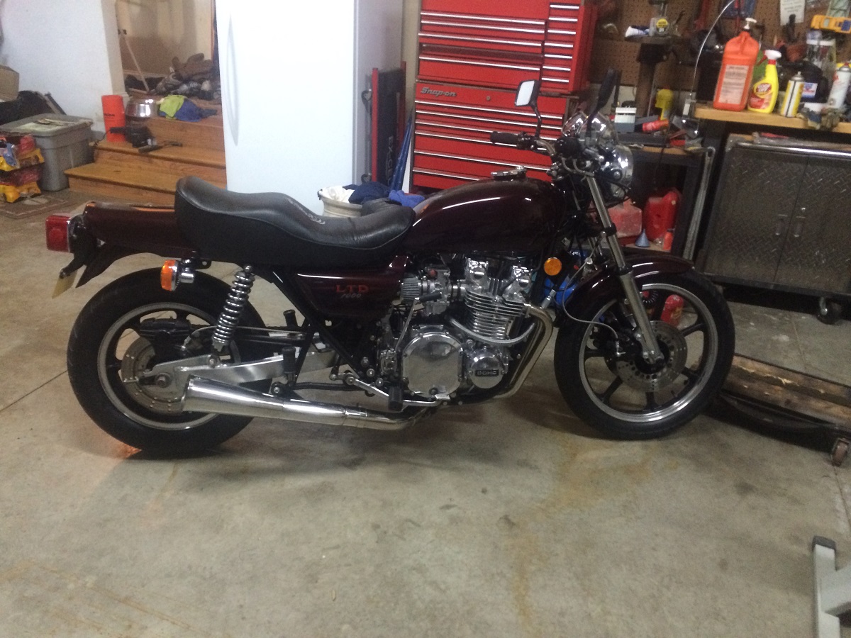

07 Jan 2016 03:17 - 07 Jan 2016 03:17Kwaker2000 wrote: £250 in England they also have them in USA here is a short video it sounds great and its on a kz1000
sorry for the swearing
This actually my bike!! The guy in the video is the guy i got it from.
I can tell you the exahust is fine for me .. Now that said I have run Kerkers but i cant say which i like better.
No rejetting? All I know is when I got it from him it was very very lean .. 110 mains and 15 pilots .
I put 115 mains ans 117.5 pilots ..was still a smidgen lean . I now have some 117.5 mains in ..waiting on my tank.but i think Im about there.
