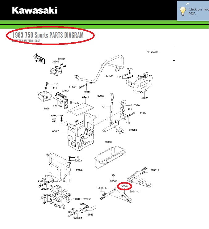

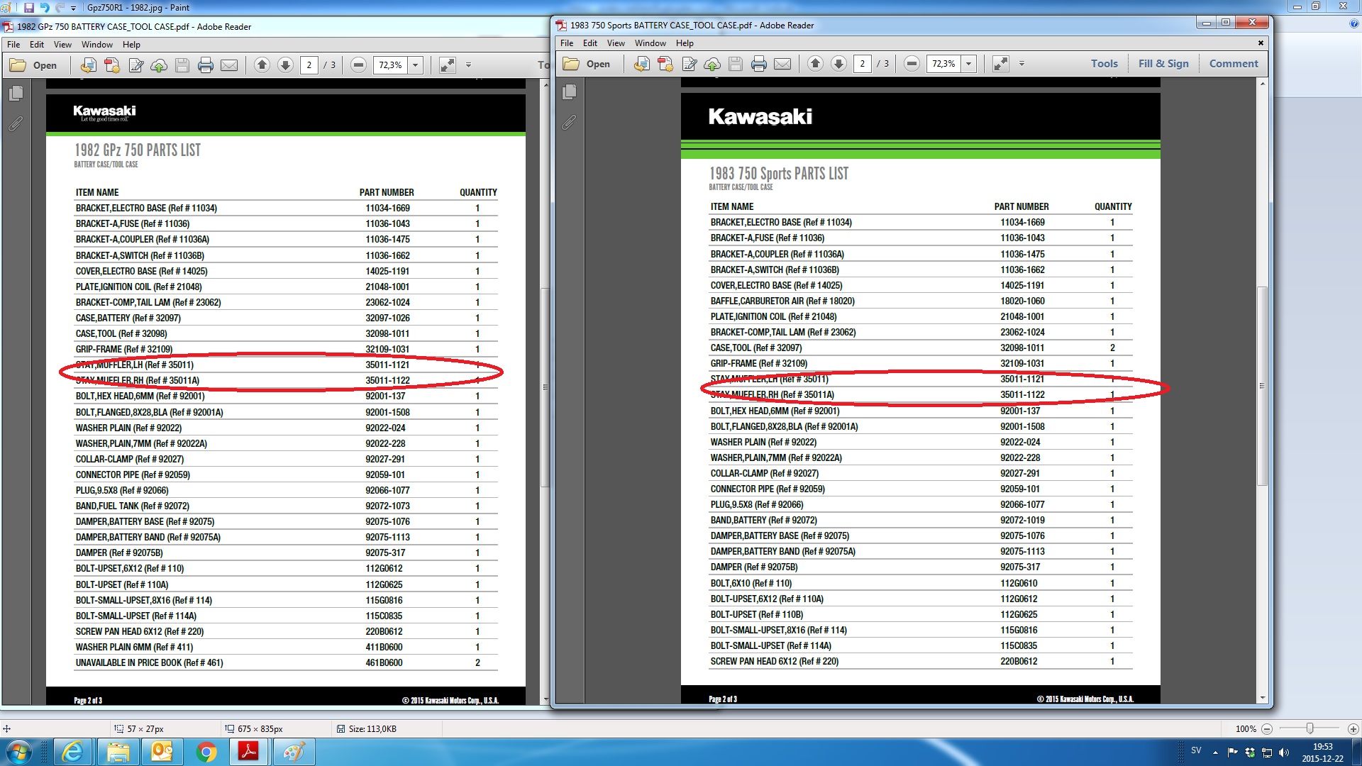

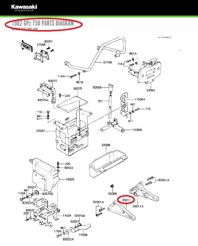

- scubaanders
- Posts: 558
- Thanks: 240
Re: Exhaust for the 1982 GPZ750-R1
22 Dec 2015 08:57
Sure thing.
The R1 and L3 has the same engine mounts among a lot of things.
What’s most interesting in this case are the STAY,MUFFLER,LH (Ref # 35011-1121) and STAY,MUFFLER,RH (Ref # 35011-1122) basically the plates that supports the original exhaust and the passenger foot pegs.
The right hand side plate is most commonly used to anchor aftermarket 4-1 exhaust megaphones.
I will not be a witness for all brands, but I know for sure that the Vance & Hince and Devil exhaust use that plate for the rear mount, as I went through a number of those during my track days.
Anyhow, the part number for these plates are the same on the R1 and L3 therefor it will be most reasonable to assume that a exhaust from a L3 will fit a R1. I will not commit seppuku if I am wrong, but one thing is for sure, the E model exhaust will not be a direct fit as these plates on the E has another part number.
But if worst comes to worst, Stein adjust the holes a little.
