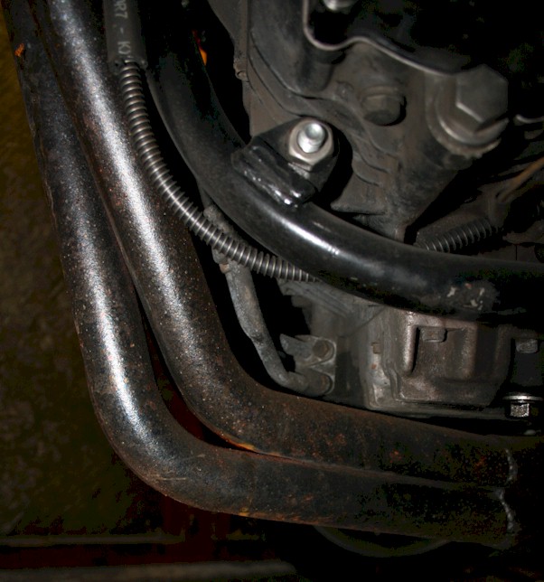

Here's a Mac header. Notice it has extra bends that bring it much closer to the motor.

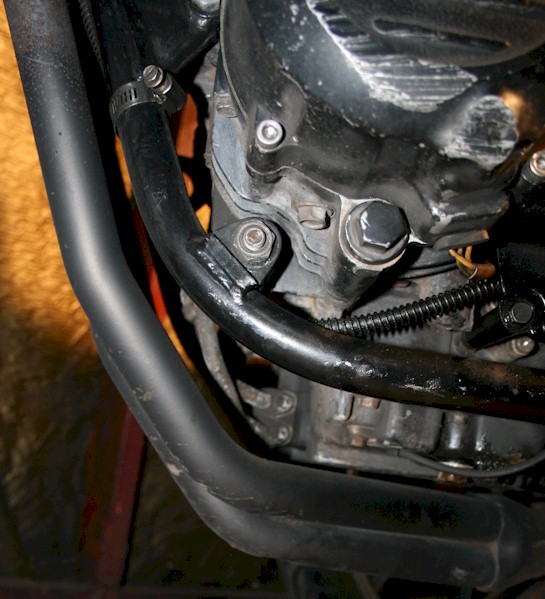

Here's how it looks under.
The problem is that it doesn't go straight under the bike, it comes out on the right side behind the rear brake pedal.

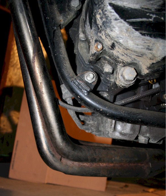

Here are two other other 550 aftermarket 4-into-1. Notice it doesn't have that extra bend on the down pipes, so it is not so tight against the motor.

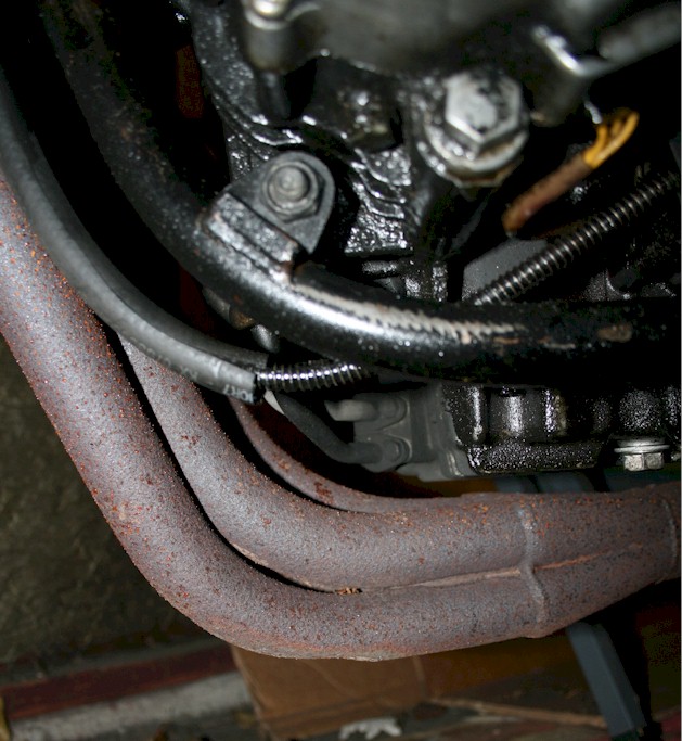

Now here is a 650 header fit onto a 550 bike. Notice it hangs much lower under the motor.
