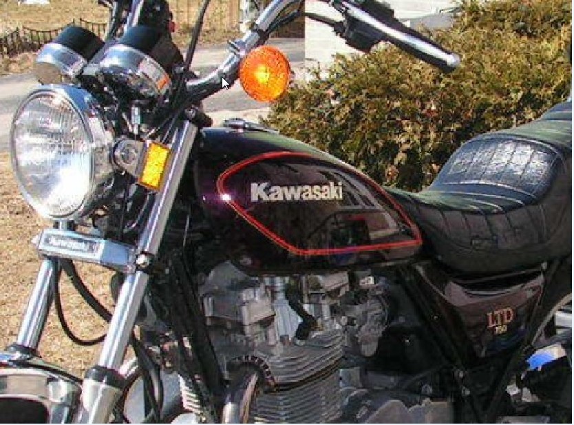

23 Oct 2015 14:08 - 23 Oct 2015 14:17It does on 750 twins which is what the "750B" series is. The 750B4 is 1979, B3 is 1978, B2 is 1977, and B1 is 1976. The head gaskets seep oil right at the front. There is a small 10mm bolt that is supposed to stop it but they leak anyway and the oil blows backward leaving a black "scum line" around the head cylinder interface. If you look at pictures of old twins, you can find the leak line.RonKZ650 wrote: The head gasket doesn't leak generally..
It is true that the tack drives are also notorious for leaking. As suggested, dry and clean it as much as you can and try to isolate the leak point.
This picture is low res but it shows what I was talking about.
1979 KZ-750 Twin
