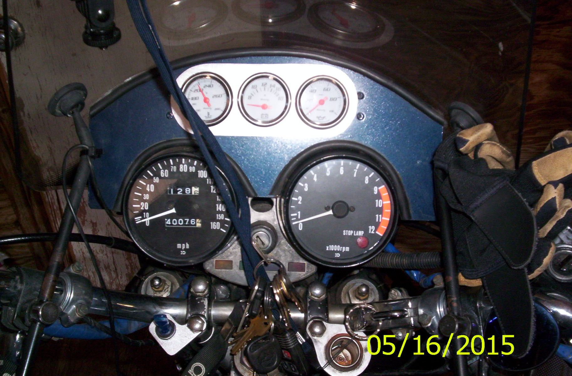

thanks, i have some bolts in there for now, no air valve.
still dont know if the non air valve caps will work , same thread an size???
i dont know what to do with the forks, 35yr old, not leaking. seem kinds soft. ill look into new springs
