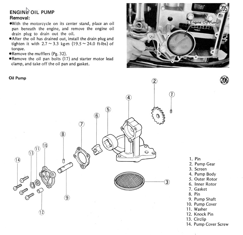

I doubt it's the cam chain. If the oil pan is off, I think you can look up and see the bottom of the chain where it goes around the crankshaft gear. See the picture below. The cam chain should be just above the pump.
Here's the manual for the oil pump. If you have the screen off you may want to spray some carb cleaner up and into it to clean out the debris.

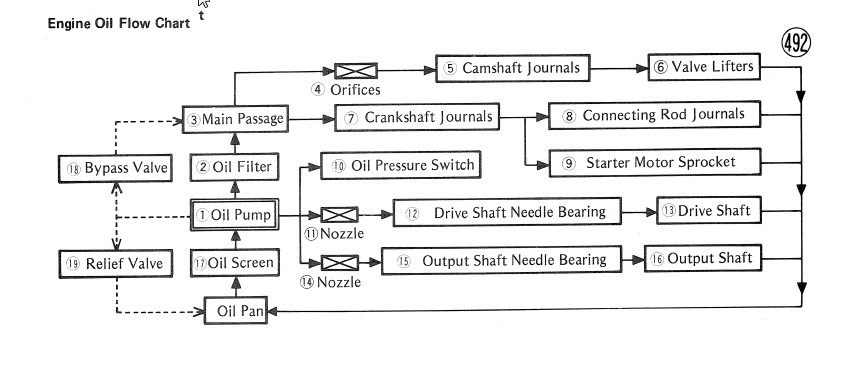

20 Sep 2015 14:31 - 20 Sep 2015 14:33FIRST: I would find somebody with an oil pressure gauge and measure it so you know what's going on. Metal shavings plus low pressure point to one thing: damaged bearings. Attached see the oil flow chart from the factory manual. Notice the flow goes through the filter and to the crankshaft (bearing) journals and then the (piston) connecting rod journals. If there is wear in those bearings, the physical spacing that the oil flows through increases and that means the pressure drops.
Is the pressure light coming on at idle only or all the time?
One thing you can try: put in 20-50 oil and see if it improves.
Like I said, I would get a pressure gauge and see what it is actually putting out. It could be wear in the oil pump but that's unusual. Mine had 80k miles at rebuild and the pump checked like new for wear.

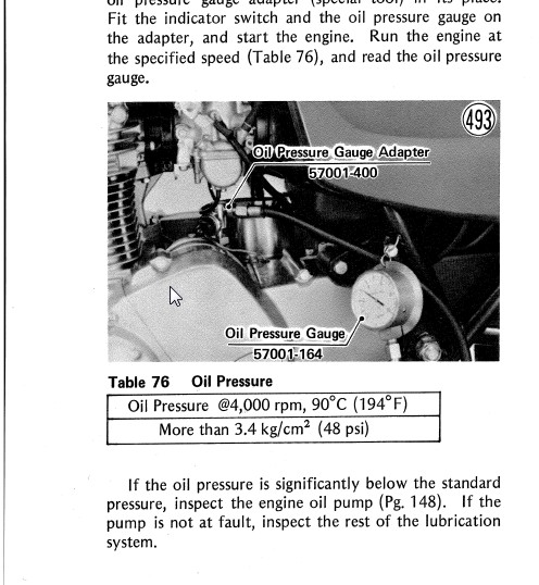

If that's the case, it sounds like engine wear and very likely the bearings. You could see if 20-50W oil makes any significant change. I would still check pressure with a gauge.
The manual only gives a spec at 4000 RPM (see attached). I believe the warning light comes on if it drops below about 5 psi (?) ballpark.
I have read posts from other people with bikes that flashed the light at idle and they still rode them. Not sure how safe that is.
