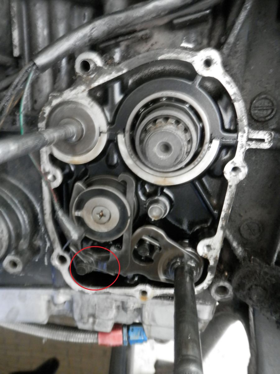

We have the same bike
Earlier this year I had that missiion cover off - wanted to check the output shaft bearing which was fine - and for sure there was nothing like that in there .
Heres a photo of what I saw which is same as yours. Ignore the red circle at bottom left
Good luck
