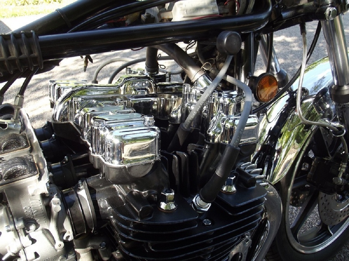

You can trace the covers out and make your own if you have access to a scroll saw or band saw. I ised some 3/16" aluminum to make these for my 1300 project.

Nice job Tyler !!
