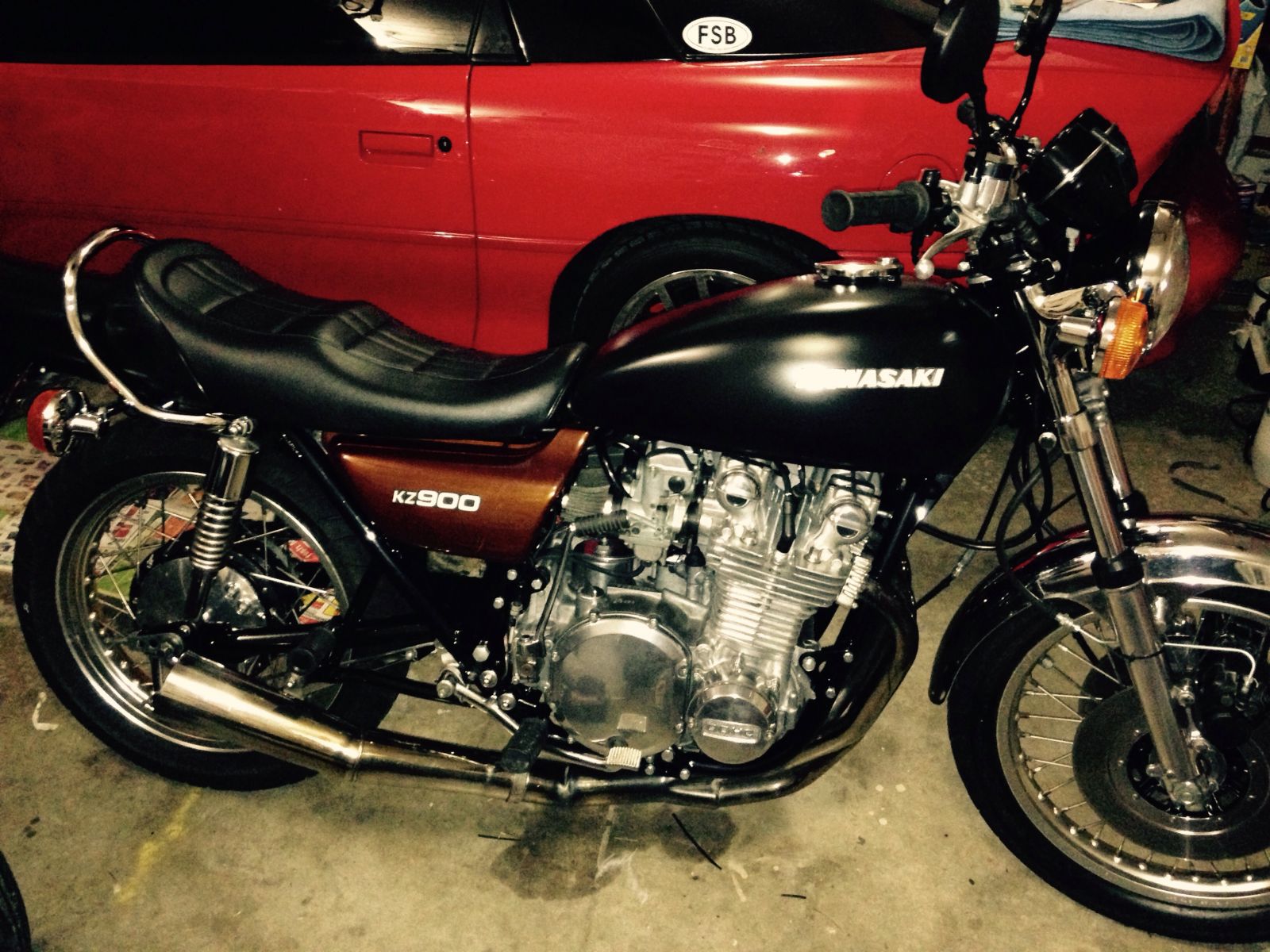

I'm putting the finishing touches on my project 76kz900 and found to have an exhaust leak.
Seams like the copper ring are too thin.
Exhaust clamps are tight against the block.
Also notice the lip of the exhaust installed is thinner then a n extra Kerker I have but can not use.
Is there a a brand that are thick?
I'm using Vesrah

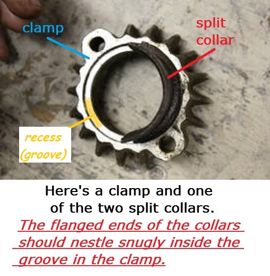

23 Aug 2015 19:42 - 23 Aug 2015 19:43martin_csr wrote: Z1Enterprises.com sells various fiber exhaust gaskets that are thicker than the stock type.
Search exhaust gasket.
Stock copper:
www.z1enterprises.com/ItemDetails.aspx?i...00&item=EM13-87827-1
2mm thicker
www.z1enterprises.com/ItemDetails.aspx?i...50&item=EM13-87851-1
for reference

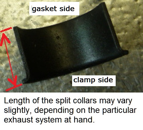

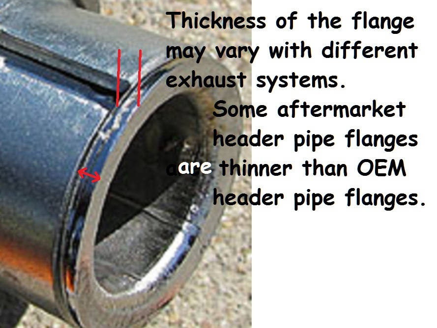

Re: Exhaust copper o-ring to thin
24 Aug 2015 06:12
Yes...new copper gaskets.
I have three set of split collers all same length.
It the lip on the exhaust is thin.
I have aluminum wire...going to shim it.
