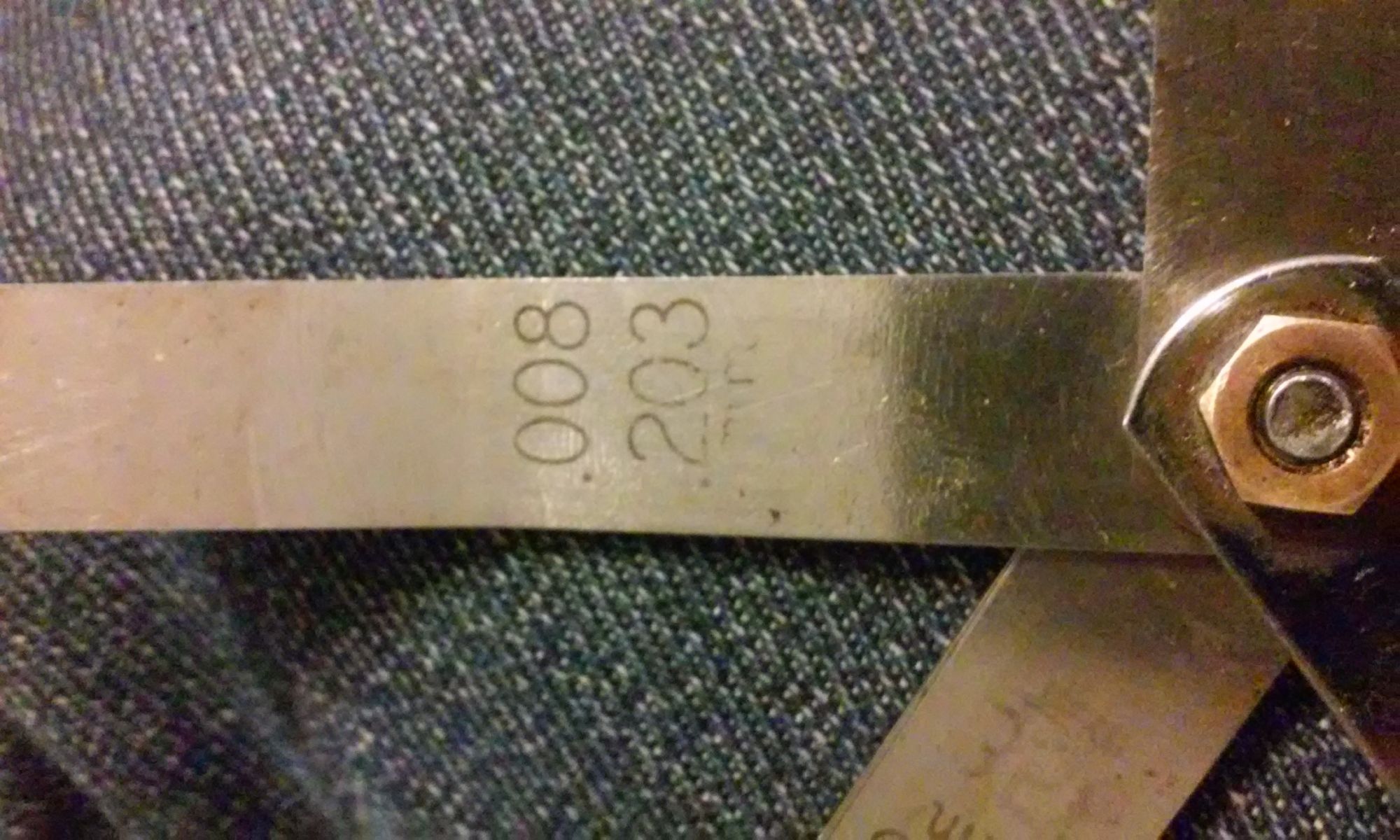

Not sure which number is mm?
.008 inch = .203mm
.008 inch = .203mm
Last edit: 20 Jul 2015 18:10 by JR.

20 Jul 2015 18:14JR wrote: Not sure which number is mm?
.008 inch = .203mm
Ok ok. Well in my manual it says the valves need to be at 0.15mm
