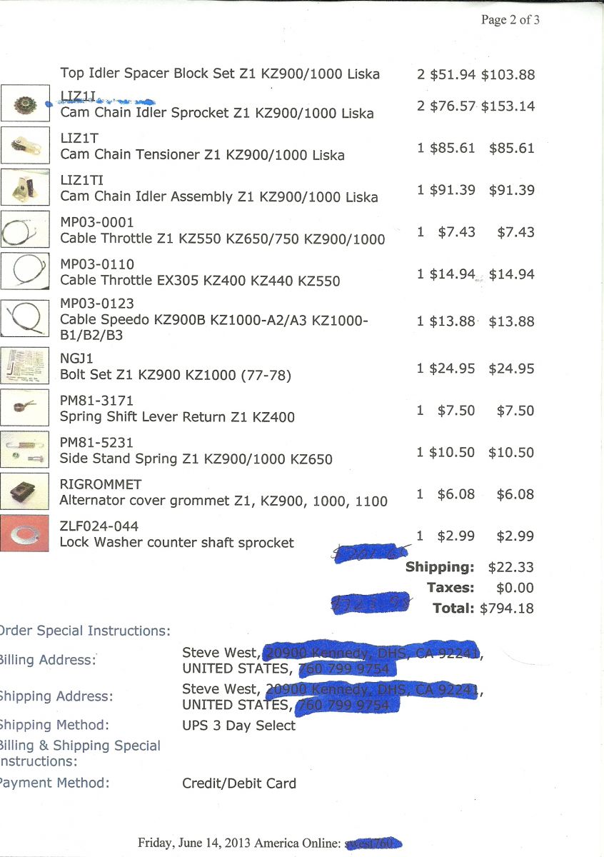

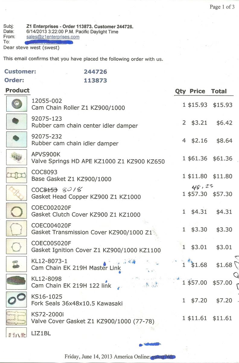

That's what kept me down for so long, plus the fact I didn't non op the bike. That's $600 alone. The Kawasaki rollers and parts are "rubberized" meaning they will get hard, crack and come apart with heat and age. Z1E is not the only place to get good parts but it is where I bought mine. I went with Liska rollers. They are 1/2 the price of stock and will last much longer.

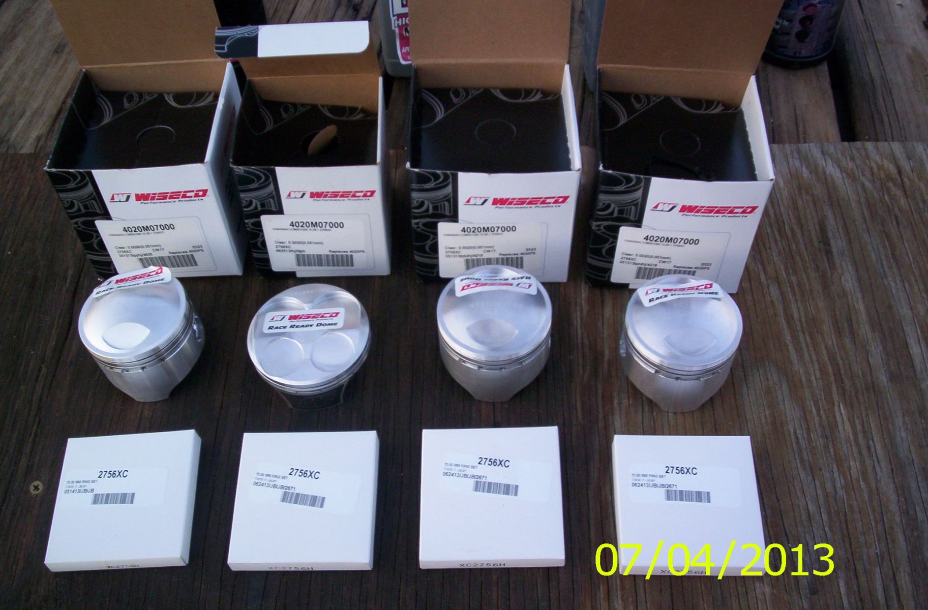

The list above had some double entries. I caught them before shipping. The Wiseco's were expensive and the sleeves were not in stock. I had to reuse the ones I had which were marginal. The idea was to get everything I needed one time and do it right. Having to buy new pistons made that impossible. My old Wiseco's are cast forged aluminum and they don't make them anymore. One was galled so I had to buy a new set. So much for going through the head. I rode it but had a oiling problem and ruined another piston. This time I bought a stock low mile block and piston set, reworked my oil pump and after a year and a half of fouling plugs, I went through the head. New valves, springs and seals. I tried to order a new piston, not in stock. Maybe another two weeks. I ordered Four new sets of rings and started looking for a piston elsewhere. No one would sell me just one. I finally found one two years later.
$112 complete with rings. Free shipping. I'm getting ready to tear it down one more time.
I guess what I'm trying to say here is, shop around, don't buy NOS and do your homework. It will save you time, grief and money in the long run.
