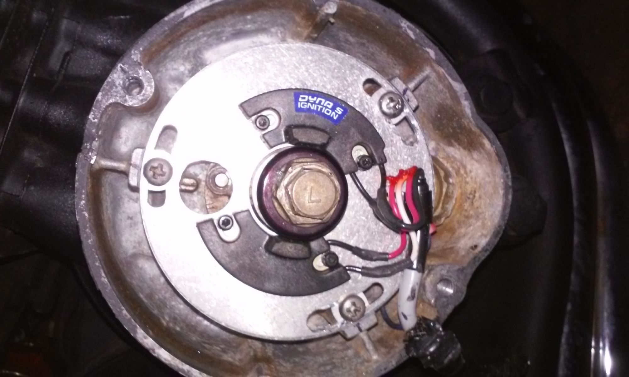

well the last time i took the clutch apart i replaced just the clutch springs they were totally worn and i was slipping like shit. now its not slipping anymore BUT maybe it is at those higher rpms...i checked the friction plates at the time and they were in spec. maybe i should just replace them now? idk. and my timing isnt stock...i looked at it today. its a newer style but idk what it is or how to set it.

Also need to research the ignition and try to find directions for setting it out and checking, it could be off ???

How do you know for certain your timing is off? What exactly is different/non stock? pictures say a thousand words.
