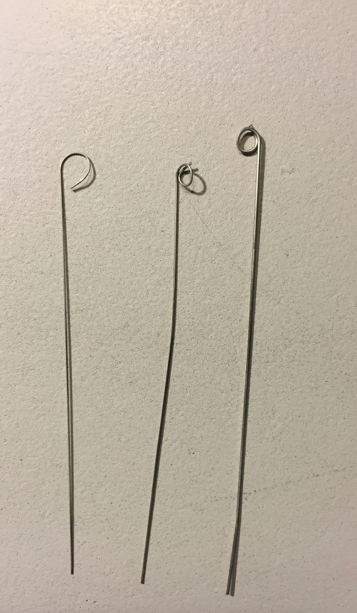

I see some guys selling welding tip cleaners as carb cleaning tools.... I have those too, for the right reason and certainly not cleaning carbs.
But I haven't found anything as good as a .009"-.010" high E string from an electric guitar!!
I keep, in a tall skinny medicine bottle, a number of different dia guitar strings but the largest that will fit those tiny (nearly impossible to clear out with out using a guitar sting) offices .... .016".
My choice"
.009", .012" and .016"
My choice"
