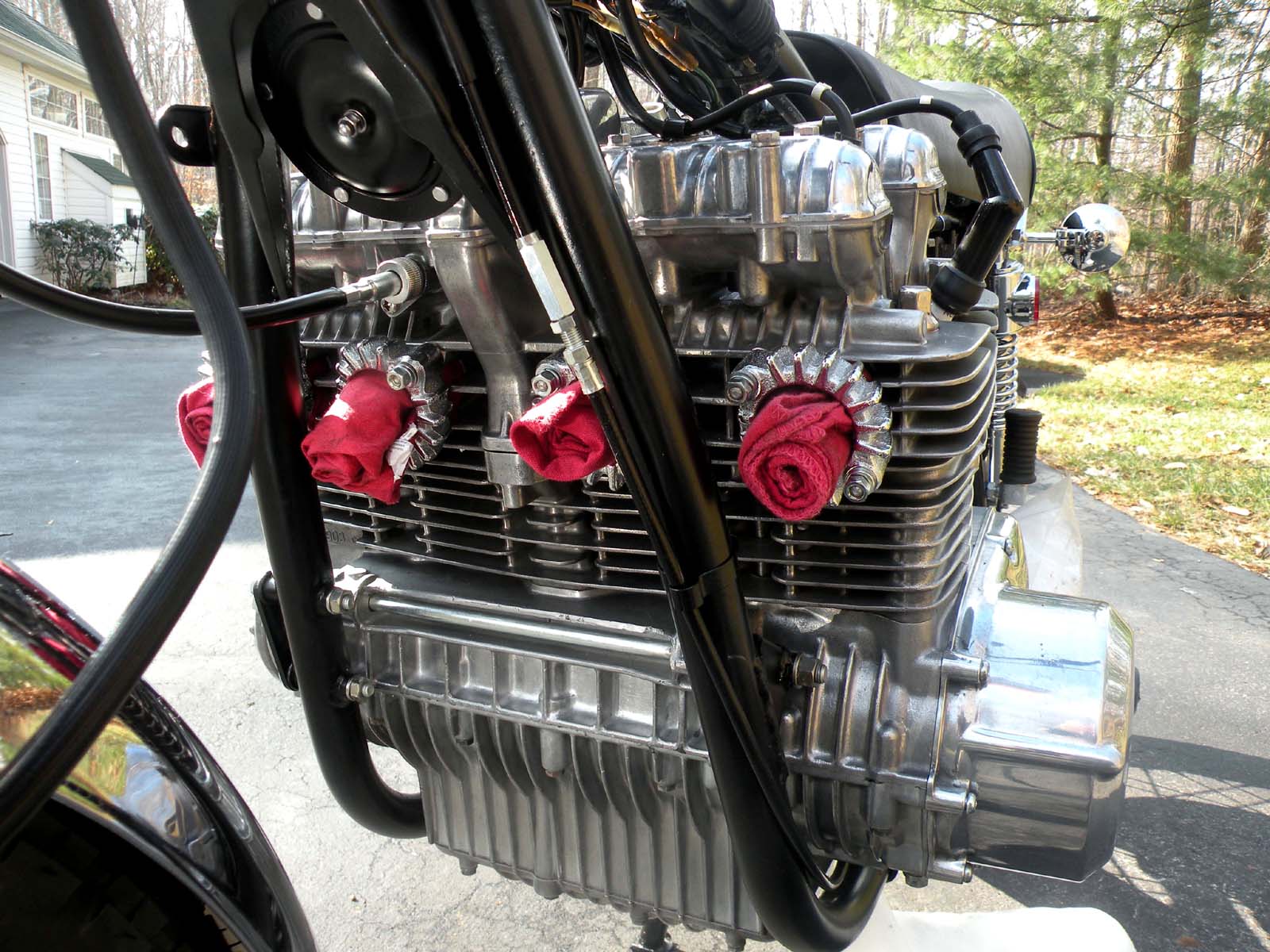

Try a Nyalox wheel brush made by Dico.
dicoproducts.com/nyalox.html
Most hardware/home improvement stores carry them. I normally use the Blue (240/fine), but you may need to start with the Orange (120/medium). The 4' wheel gets in between most fins. They make 4 or 5 different styles that will get into most other areas. As you use them. you'll notice the brush will turn black with build-up and the surface finish will start to dull. Spray the brush with brake cleaner and dry with towel to restore. They actually give a slight sheen closer to vapor blasting. You're going to spend a few hours, but the results will be worth it.
Here's a before / after picture of a Z1B engine I did using Nyalox brushes.

17 Jun 2015 11:48 - 17 Jun 2015 11:51MDZ1rider wrote: Try a Nyalox wheel brush made by Dico.
Wow that is impressive. looks like it polished it a bit as well. Did you remove the engine from the frame? I have a 750 twin engine i don't want to break down that i was going to soda blast then polish. i may just try one of these wheels you speak of. Nice work.

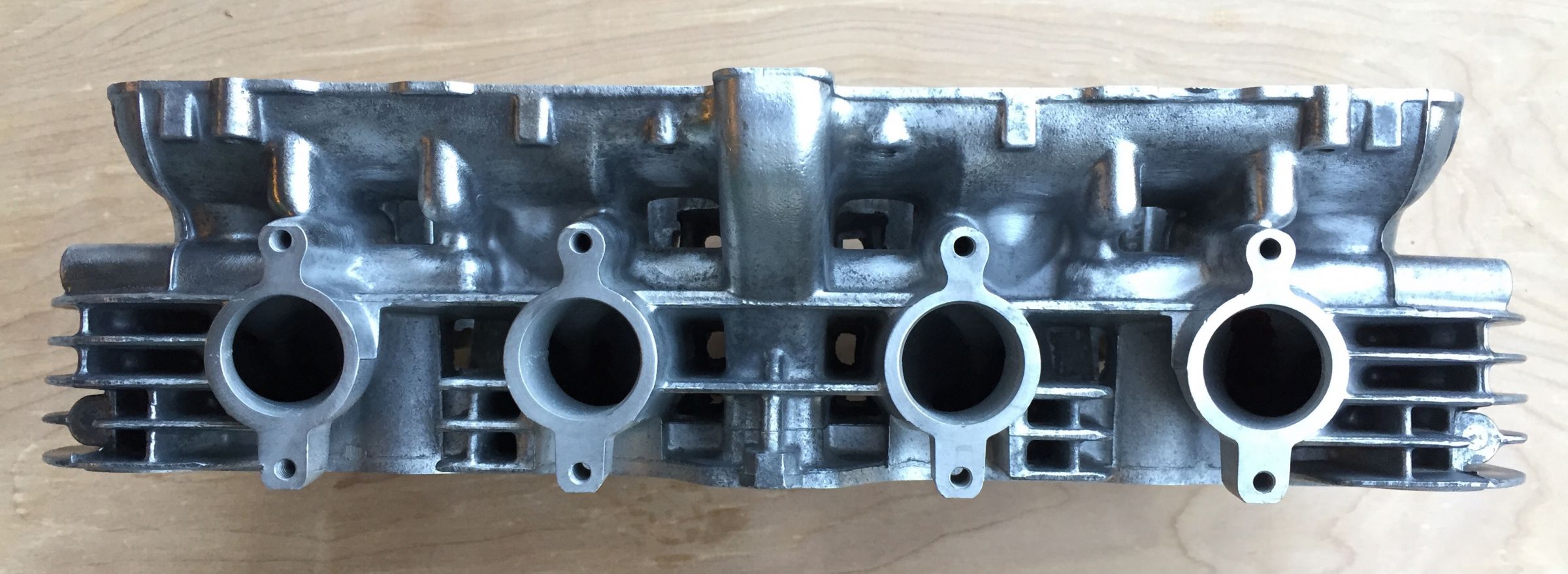

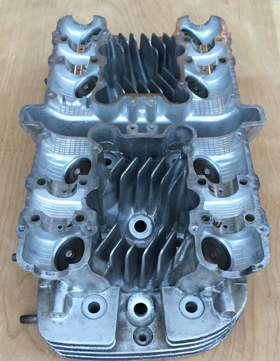

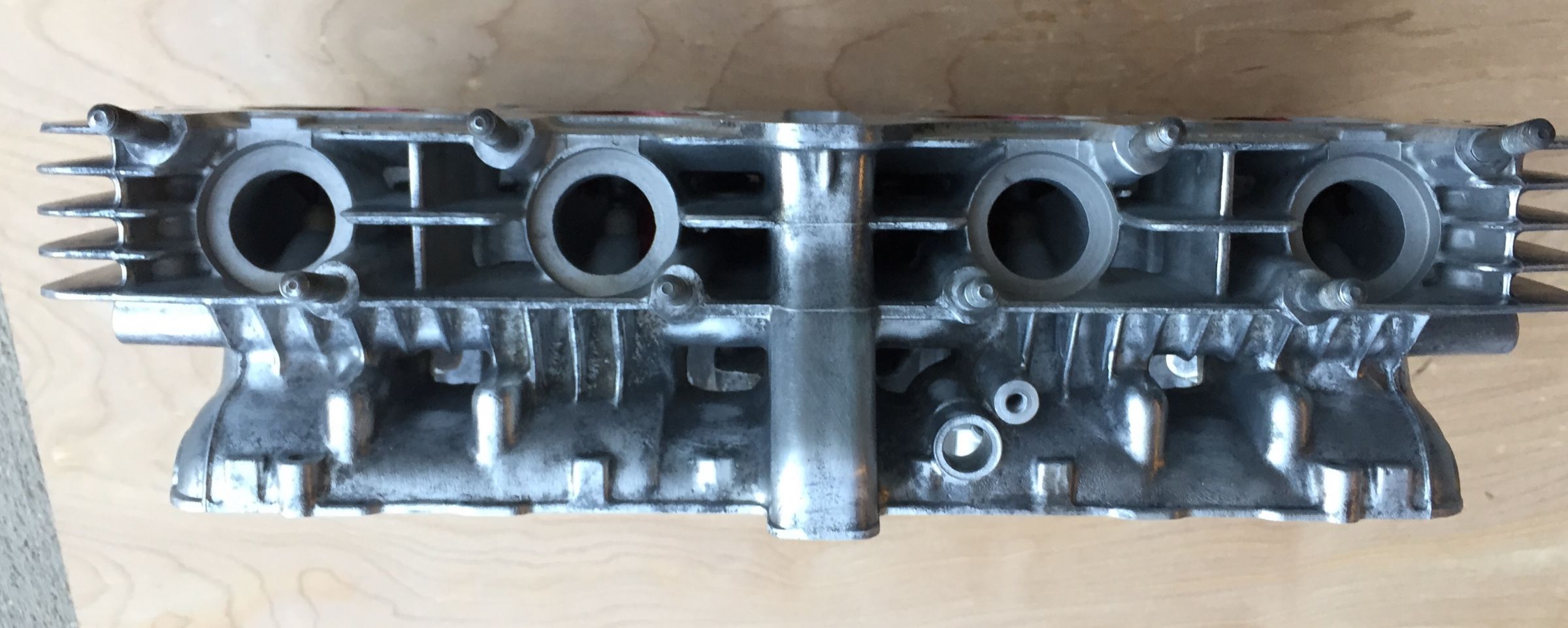

Re: My head is ugly
20 Jun 2015 10:28 - 20 Jun 2015 10:39OK I spent close to two hours on this with an orange wheel and the blue wheel.DoctoRot wrote:missionkz wrote: OK found the 4", blue and orange ones at the local Ace Hardware store.
I'll give it a try before the weekend is over.
Max RPM is listed at 2500rpm.
So that means battery and 120v drill motors.
Cool. Id like to see your results.
I think it is coming along.
Compared to a few weeks ago:
www.kzrider.com/forum/2-engine/598299-my...ugly?start=20#676842
After this, I would attempt to take a couple more hours and hit it with my little soda blaster and get that old school sheen back!!
Attachment Head3.jpg not found
Bruce
1977 KZ1000A1
2016 Triumph T120 Bonneville
1977 KZ1000A1
Last edit: 20 Jun 2015 10:39 by missionkz.
Re: My head is ugly
20 Jun 2015 11:03
Much better.
