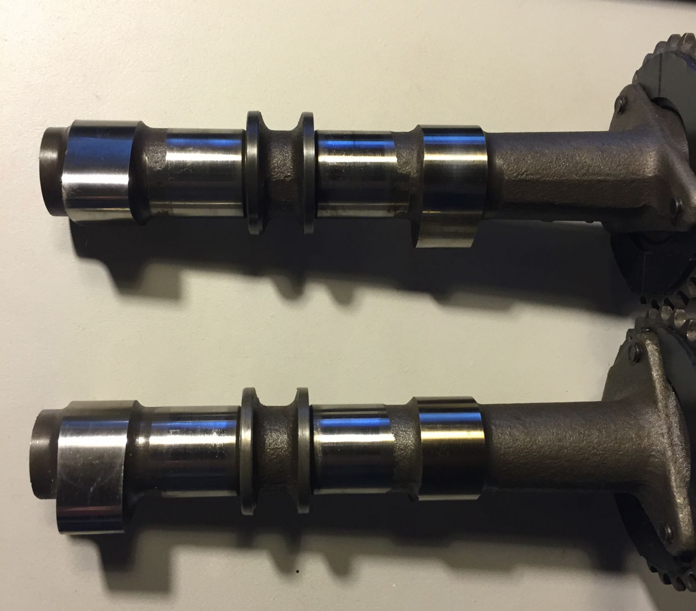

28 Apr 2015 23:08 - 28 Apr 2015 23:10You might luck out.... don't get the bearing inserts mixed up... actually, they may be damaged now... have to see a picture,Garbosh wrote: That's a lot of fancy words haha. Ill be doing the JB Weld route. The two pieces fit together perfect like a puzzle so that's good. Ive put a bead of jb in the crack, squeezed them together, and with a rubber band tight around it, itll be a good amount a pressure keeping it together while curing. I then used a wet paper towel to remove the jb flashing on the cam side, as that is the most crucial. On the other side a put a layer of jb all over the top for extra support. Ill wait until Thursday to touch it up with a dremel or a sanding block and prey it works. Im pretty confident it will.
And make sure you understand the low torque limits of those cap screws.... it is inch pounds.... as in "kinda tight with an open end 5" long 10mm wrench" not super tight!!!
That might be how it was cracked in the first place, during a clumsy assembly.... by not moving back and forth both sides of the camshaft when tightening them down.
You are compressing valve springs when doing it and one side, if torqued down crooked or one whole side by itself, you could get them jammed and maybe crack a bearing cap....
Note, the left sides of the cams have those two parallel rings.... yours has them too and if they hit the bearing cap by mishandling the cams during installation.... I can hear the snap crackle pop.....
Not much clearance under the caps for those "rings".... make sure you gobs are on top and not under the cap center.
