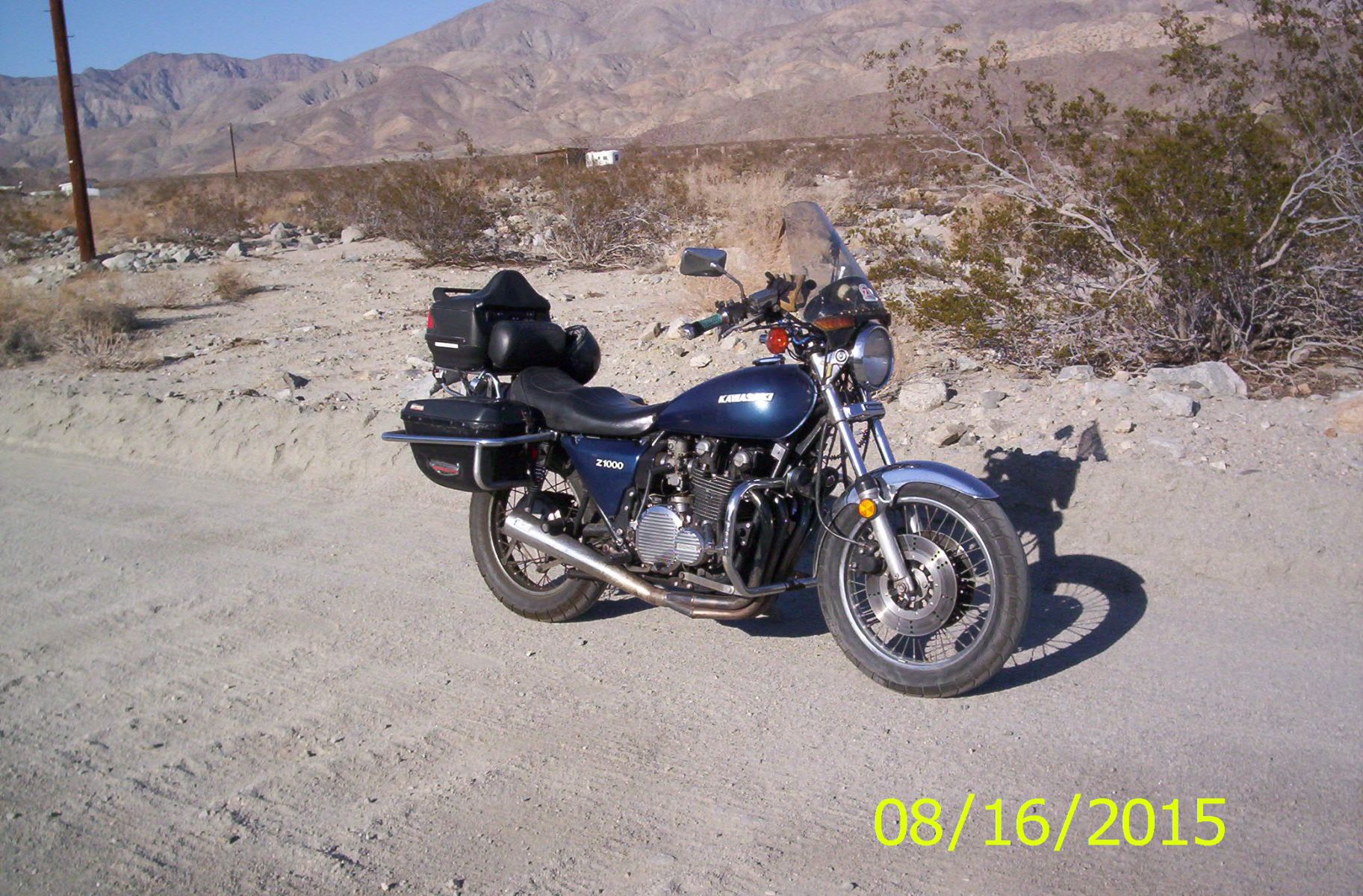

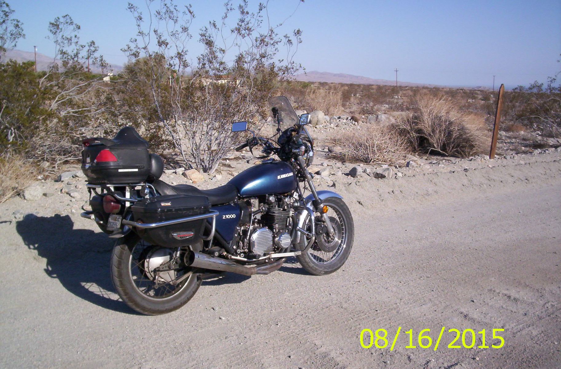

Unless you're going for a full out drag bike, stock valves and 10.25/1 pistons, plus some good cams will make it scream. I have the stock 1015 8.5/1 pistons in it now, 33mm smooth bores, 1X cams, a little tweak here and there and a V/H 4/1. Most riders I come up on want no part of Bossie. Get it up to 7000 RPM and got full power through the red line.
Some will come up along side, blip the throttle, before they know it, I hit the red line and power shifted leaving them behind. Oh sure, they will come screaming by me, but the race is already over. :lol: All I need is my copper head gasket and I'll have my Wiseco 10.5/1's back in. Won't be long now.
She needs a bath.
She needs a bath.
