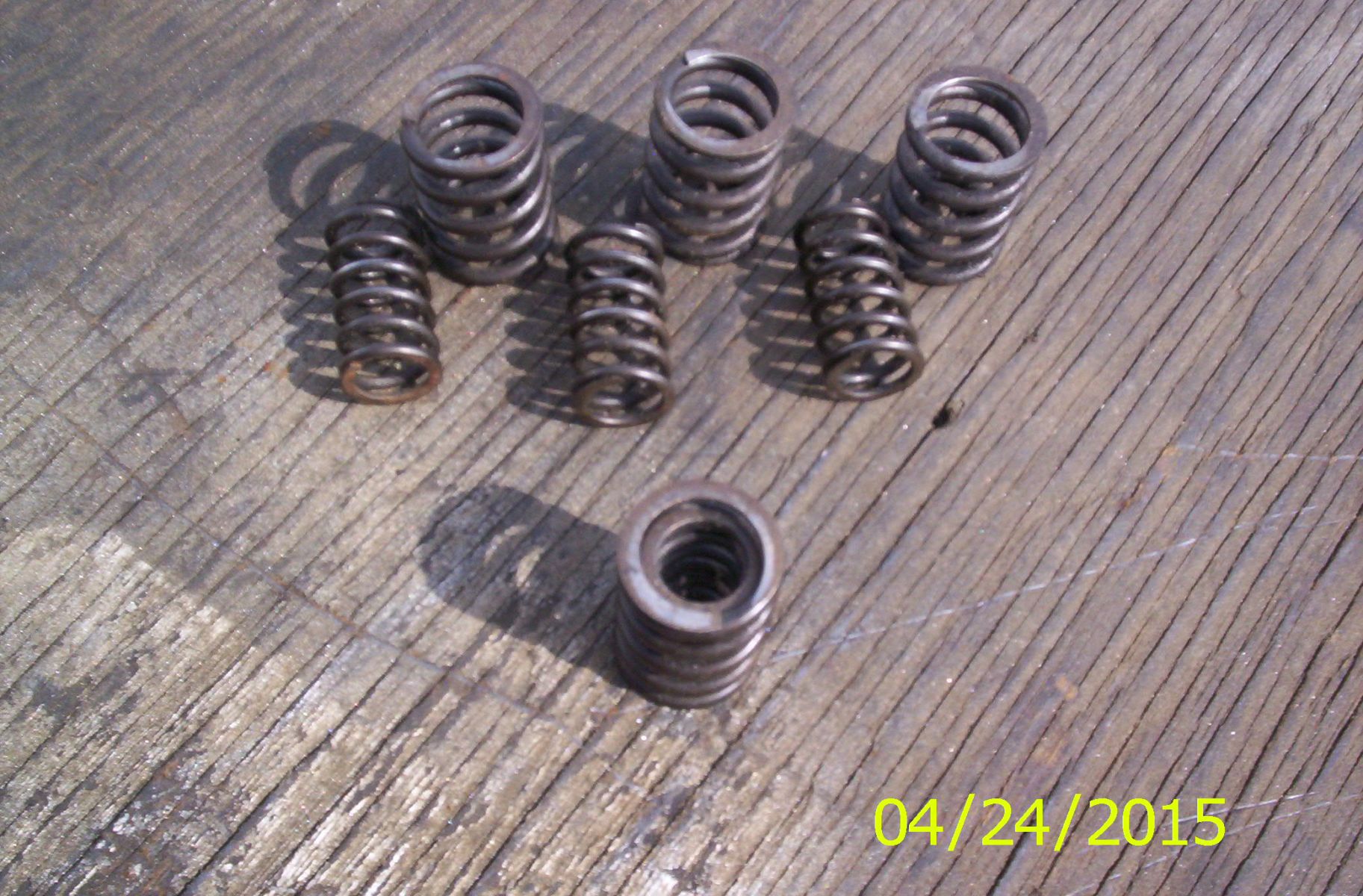

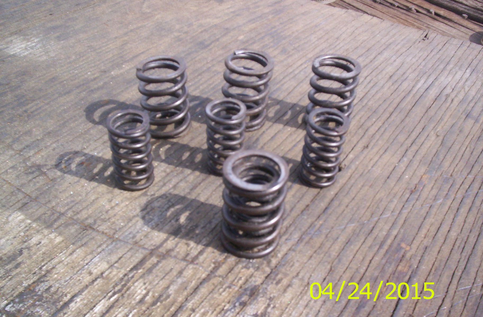

These were used in 87 when I put them in. It's a wonder they worked at a;;. The inner ones were rubbing on the outer ones.
I couldn't get the last one apart. $65? No brainer.
