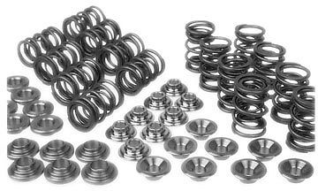

I would also add replacing the valve springs. They can test good but have issues while running.
/ :evil: Well worth the $65 for peace of mind.

Thanks for your input, everyone. You've affirmed some of my own apprehensions. The guy who gave me the quote is a friend of my brother's, who runs a performance shop on Long Island. I trust him, and his work is excellent, so I think ultimately he may just be prone to suggesting such an extreme amount of work.
As suggested, I think I'll stick to the grind, valves, guides, seals, and springs. Besides, I've never really been a fan of doing things that can't be undone.
