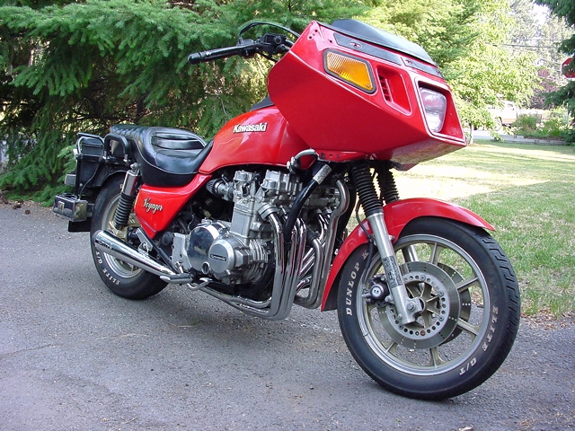

I see from your drop box pictures that you've eliminated the air box. Would it be possible to fabricate some sort of manifold to reconnect the breather to the intakes?
That's what I did to two of my pod filters on this bike.
