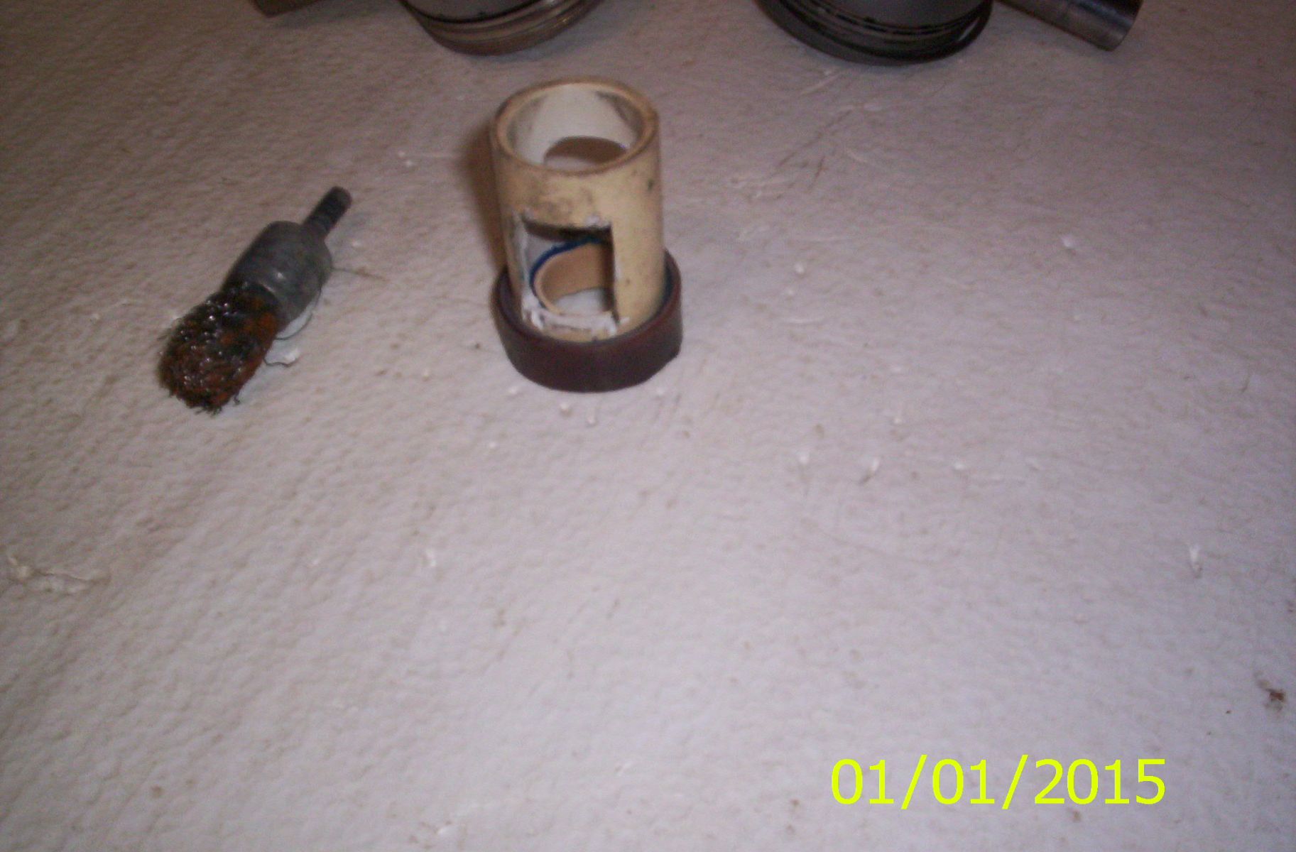

I use a C clamp with a PVC fitting to get at the keepers. You have to use a deep socket first to loosen them.
You could use a cut out deep socket as well.

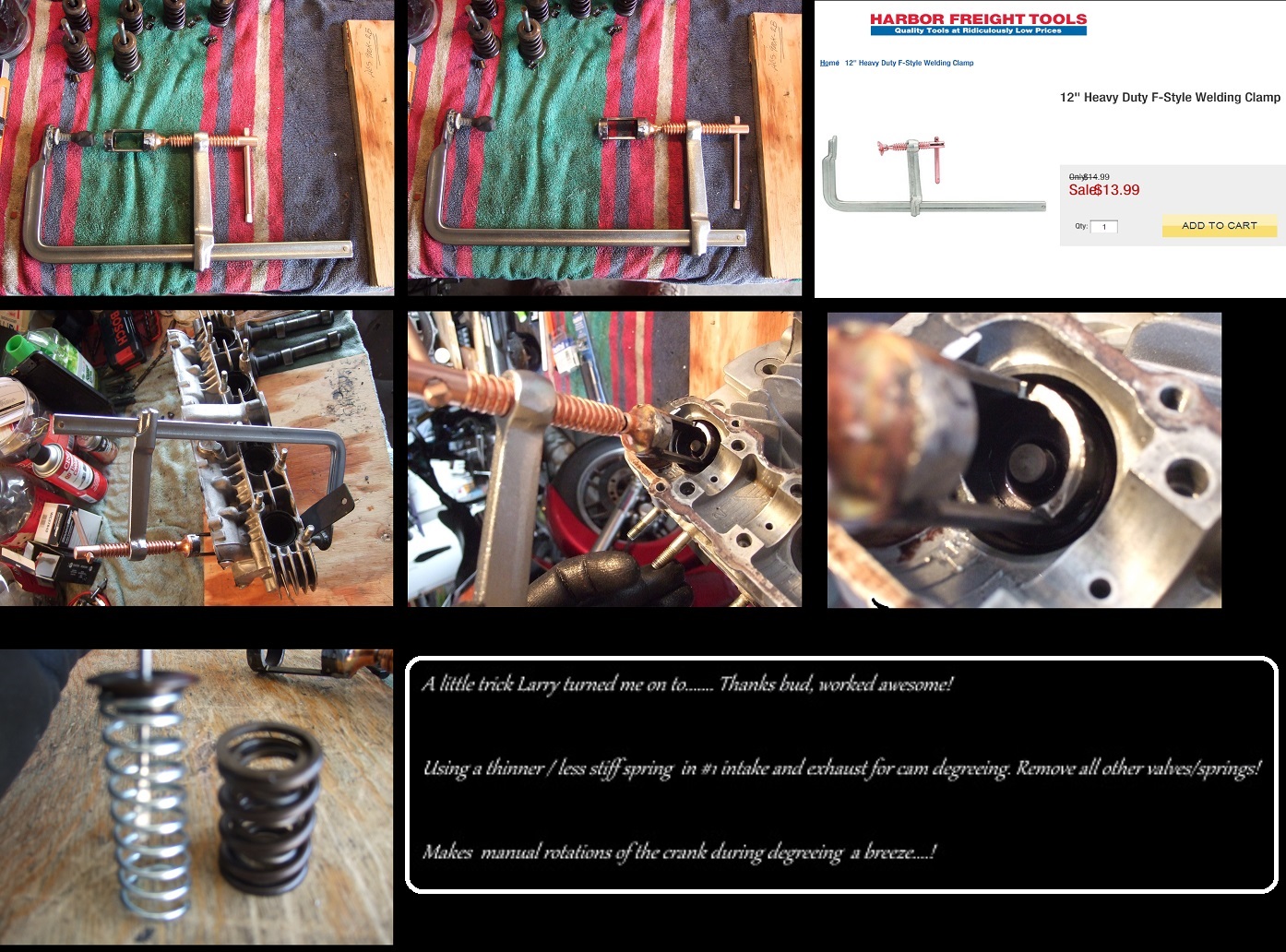

If you have the means to build your own and like doing this type of stuff... Make your own.
Harbor freight tools clamp $14

29 Mar 2015 07:53swest wrote: Hey, hows your ride going? Like to see it.
The baby is now 8 weeks old- which gives me a bit more time in the garage. I'm almost done! Just waiting on the 4 oil passage o rings for the head studs.
Don't want to hijack this post- I'll post more pictures to my thread later today.
