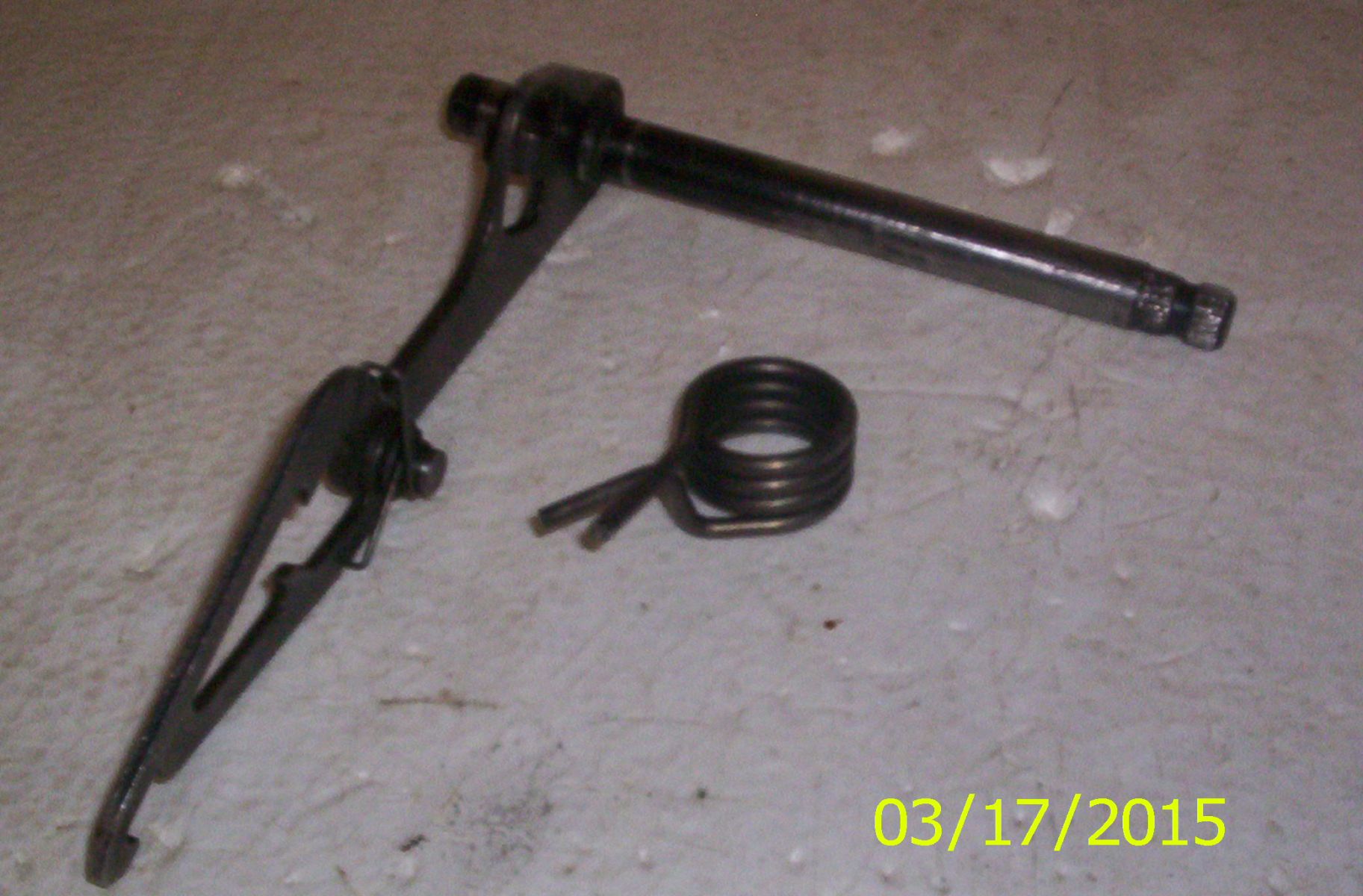

Re: Replacing shift fork on KZ1000ST
17 Mar 2015 07:01
This is the shifting arm and spring. I got it from oink johnson on eBay. It was rusty and he said the splines were good. They're not. I should have checked the Old Kaw Man first.
Before tearing into the cases this should be checked first.
