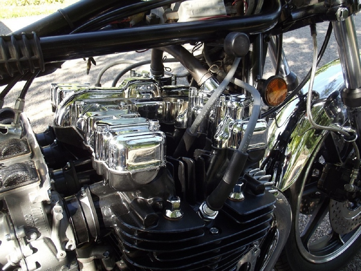

Don't listen to the anti pod guys, you can get them to work just as good as the stock airbox. If you have the stock exhaust do this. What style of carbs are on your bike, CV or slide? If CV then go up one size on the main jet and place a shim under the needles. If you have slide carbs, go up one size on the main jets and move the needle clip down one slot and up the pilot jet by one size. That should get you pretty close.
I have been running pod filters for a LONG time on a bunch of different bikes and I have gotten ALL of them to run correctly.
This bike has had pods on it for over 30 years and 150,000 miles, it runs perfect. Starts easily, pulls hard and smooth, no flat spots, is not effected by wind or rain and I have ran it from sea level to over 13,000 feet and it runs great. As for the caps on the valve cover, simply connect the two ports together with a hose.
[IMG
  • pete greek1
  • pete greek1's Avatar
  • Posts: 1510
  • Thanks: 185
Re: Stock airbox/ K&N setup /Crankcase breather setup
11 Mar 2015 09:33
#664083
This is what Baldy is talking about
