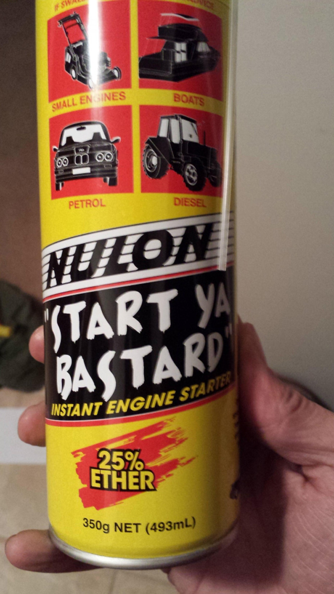

Might be time to try this...
Seriously, A blown head gasket is not going to affect all cylinders equally. It's not going to blow out the same amount on all 4 cylinders. Normally I'd say Cam timing might affect all 4 equally, but you didn't touch this area.
Some are going to cringe and tell you never to do this, but a quick shot of starter fluid may be useful in your diagnostics. You need compression, fuel and spark. I know you're confident you've got good fuel, but that's also the area you were working on when the bike quit. A quick spray of starter fluid will provide the fuel regardless of you a carbs conditon/settings. If you get a brief run with starter fluid, you'll know it's a fuel issue. If not, compression or spark.

MDZ, I'll give it a try. You are correct in that I was working on fuel when it went out. I suppose I should look into the spark thing again as I am not very confident about the condition of my coils.
