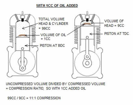

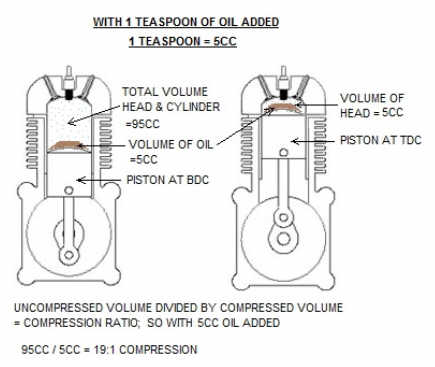

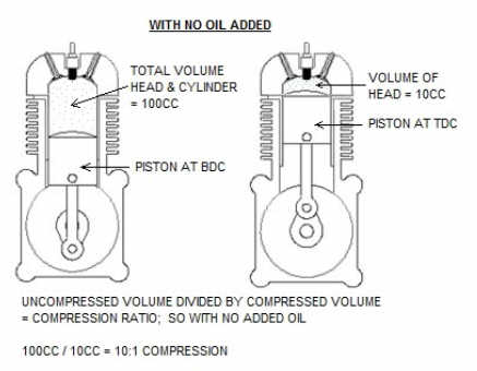

You can put a tea spoon of oil in each cylinder and see if it changes. If it goes up, rings.

If you put a teaspoon of oil in each cylinder the compression will definitely go up because it reduces the volume of air in the combustion chamber when the piston is at TDC, so it isn't a really good test of the condition of the rings. Here's a generic example of what I mean. Ed

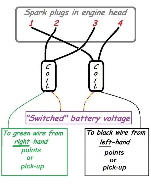

If not already done, would also double-check routing of the plug wires from the coils.

Patton, I have checked the plug wires. This is an enigma to me. It was running, I didnt change anything and no longer starts. What if it did overheat. What would be possible problems?
Racer, I just changed the plugs, charged the battery and went so far as to install the WG coil mod. To be honest though, I have no idea what the spark is actually supposed to look like. I pulled the plug out and rested it against the block. it looks to me as there there were several small arcs across the gap. I know the common thing is a fat blue spark, but is this one arc that is fat blue or several smaller ones. the arcs across my plugs (this is during the daylight) do not appear to be all that fat or blue. I checked after the WG mod. Also, I know I am getting fuel to the carbs because today I pulled the carbs and checked the float levels and cleared the jets to be sure.
