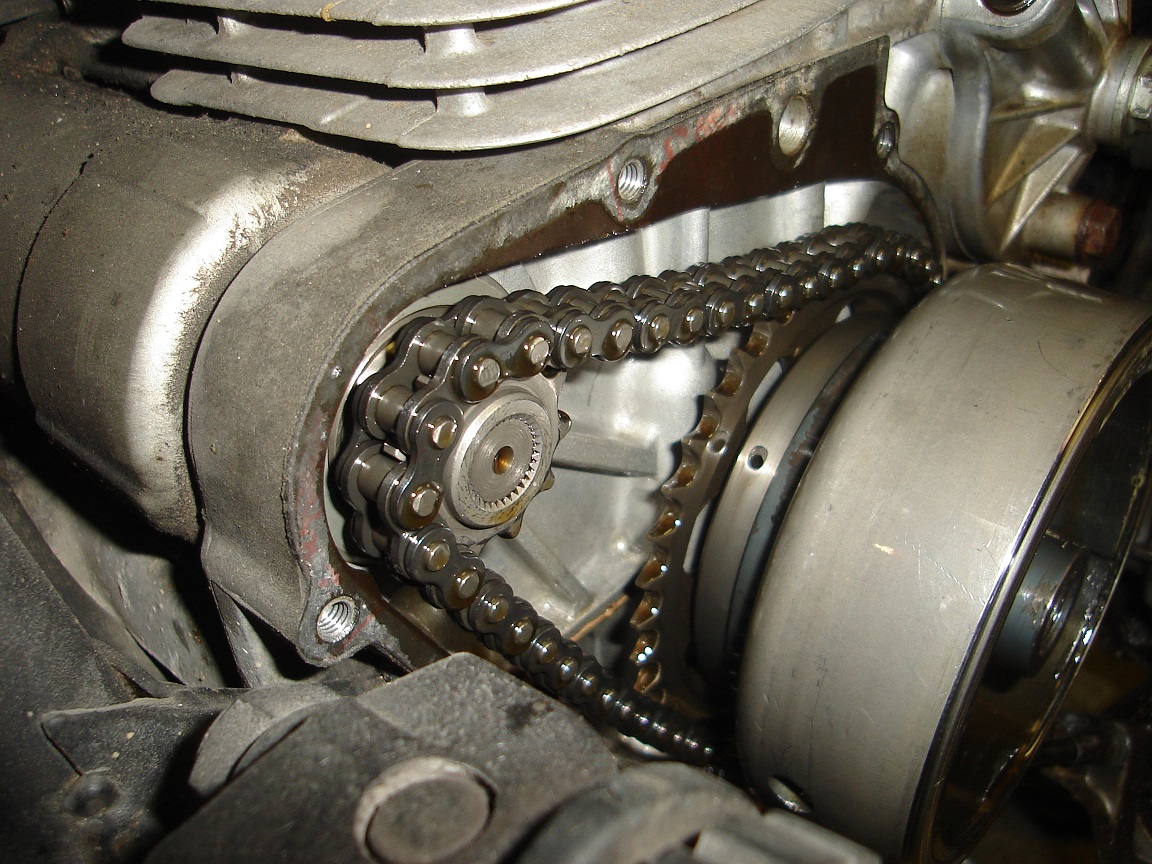

Is it possible to block the hole, remove chain. And only use the kick start instead of using an electric starter all together. I am pretty sure I can find a freeze plug that i can fit into the hole with some RVT. Anybody ever done anything like that? I wouldn't have asked if I found a thread Cheers!

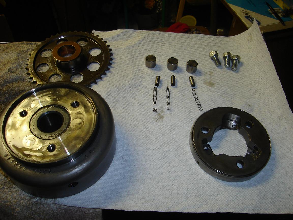

Starter, starter gear, chain and clutch can all be removed.
The clutch gear and shim should be retained as they help with oil flow from the crank bearing.
The simplest is to remove the starter, starter gear and chain and leave the rest.

The entire reason im asking is because i dont have one. And instead of spending a 100 bucks if i dont need to I wont. So if there is no starter can I leave that hole where the starter and sprocket is open or do I seal the hole?

Yes, you will want to plug the hole to keep dirt and grit out as this area is open to the crank case for oil drain.
